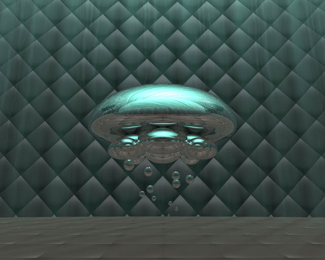

With the talk of water bubbles, I thought I'd take a shot at making some.
David
Download 'waterbubbles.jpg' (42 KB)
Preview of image 'waterbubbles.jpg'

wow, that's *awesome!* the texturing is great, excellent job! the line where
the floor and wall meet looks a little unnatural and the floor seems a little
dull compared with the rest of the scene, but this is a very cool scene
nontheless
-gene

<smile> Glad you like it. It's just a simple scene really.. Just slapped
together stuff.. The wall is a cylinder with a quilted normal. The floor is
also quilted, a plane. The water is just a box with marbled scattering
media. The bubbles are spheres and a large blob. It was more an experiment
than a finished product.
David

I really like the shape of the largest bubble, on top, but the smaller
bubbles right under it don't look right somehow, they sort of make it look
like a UFO or something.

You could be right.. I'm just working from intuition and guesswork. I
suppose I should have done a web search for some good still shots of air
bubbles first.
David

Nice positioning but it looks a little too symmetric, and shouldn't it be
somewhat transparent?
-Chris-

Actually, the bubbles are all "rgbt 1" with no normal or finish properties.
What gives them their look is the ior of the box with the scattering media,
and making the bubbles non-hollow so the media is not inside them. I figured
they'd be symetrical, simply from the relatively uniform pressures of the
water. Figuring that the only things to make them non-uniform would be
collisions with other objects and bubbles.
David

The shape is a little too regular, making it look more like a jellyfish.  I
think air bubbles are more concave on the bottom with smaller bubbles
clinging to the bottom edge.  Perhaps making them all blobs and putting some
negative blob components inside would help.  I don't know, just thinking out
loud.
-Mike

Kick-ass bubbles man!

You're probably right...but when is water pressure uniform?  Even in
swimming pools there are slight currents jostling bubbles into odd shapes.
Still, the general shape does look pretty good and lives up to DeWitt's
jellyfish theory.
I know the scene is meant just for test purposes but what really strikes me
is the media.  It looks quite natural and works well.  Do you think you
could e-mail me the source?
-Chris-

Good point about the currents. Temperature gradients would also play a
factor.
me
Since you asked so nicely, I've posted the source for the scene to p.b.s.f.
The media, as you'll see, has a simple turbulated marble density map. In my
mind, it seemed like a quick cheat to simulate light rays beaming down into
the water.
David

Nods.. Agreed.. The top bubble is a blob with a negative component pushing
up from below. Trick is, you'd really need to make each bubble a separate
blob object. Otherwise the smaller positive components would just be
swallowed up by the large negative component.
David

You forgot hydrodynamic drag, turbulence and general chaotic effects.
What you tend to get with bubbles over a certain size is what looks a bit
like a SOR of the following (very bad) ascii graphic:
----___
       ---__
----_________)
In the region marked by *'s, you get a random assortment of smaller,
usually mostly spherical bubbles.
Also, as the bubble rises, it expands (Boyle's law, anyone?) and splits
into multiple bubbles when turbulence etc overcome surface tension.
But I'm not dismissing you effort, it looks remarkably pretty, and I'm
not sure if I could do any better given a couple of months to try <grin>
Bye for now,
     Jamie.
