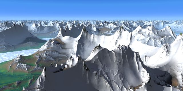

Since the animation was so garbled I figure a nice still image should be
uploaded.

Great work!
The water could be a bit darker (or is it ice?) The mountains are isosurface? is
it pure RMF or with some additional function?
How about some peak very near in the foreground ?

Looks a bit like the Pyrenees but these mountains are a bit smaller.
The grassy area looks too smooth, even at this distance you'd see much
more turbulence and unevenness there.
If the camera was much higher up then the grass may look OK.
Nice work, thanks for sharing.

You guessed right, it's ice covered lakes at the beginning of the current
animation I'm doing, then the snow and ice melts off during it in a
unrealistic sort of way.  I've never seen time-lapse done during a flyover.
Plain RMF, nothing else manipulating the isosurface unless you count the
slope-dependant texturing. Lakes are a single plane throughout.  I made the
mistake of scaling the texture on that so the water/ice surfaces all moved
in a strange way toward <0,0,0>.

Yep, if you have seen the description of the animation I explain that the
textures had caused a jittering effect, much like 'crand' had been added to
the finish, but no AA or crand was used.  To remedy I have switched to a
very flat texture for dirt, rock, grass and trees.  I thought about adding
actual tree objects someday but the grass would most likely remain texture
alone.

Wonderful. How many objects are we seeing--I'd be even more impressed if it
were only one!
Also, doesn't this just blow away the concept of heightfields--wouldn't it
be impossible to make a non-hideous flythrough if these were mere
heightfields and one lacked a Cray?
How about employing the RMF function for the ice too, so that the ice is melting
in the middle first and later on the coast.

Looks like a recently terraformed low-gravity planet...I don't think
mountains like that would survive long in an atmosphere.
Great job...have you tried making bare rock on near-vertical surfaces?
It looks like a lot of the snow is clinging to very steep slopes.

Nice idea, if I could do it.  I'll never know unless I try I suppose, but in
this particular rendering the water is all a single plane.  Guess I might
negate the same mountain isosurface somehow to get the individual lakes
where they already stand.  Could be a challenge for me.
The RMF isn't also usable as a pigment, is it?

Sure it is, you can use every function as a pigment, there are some of the
megapov-sample scenes using that, like math_pigm.pov in the isosurface dir.

You're right on the mark with that comment Greg.  The circumventing of a
need for smooth height fields to do this sort of thing may make the HF
obsolete, dare I say.  The one drawback is the need to get a fine enough
'accuracy' apparently, among other things I might not know about, which can
slow things up.  The 'eval' and 'method 2' are superb additions.
Oh, yeah.  Yes, just the isosurface with ridged multifractal function and a
water plane, some ground fog, sky_sphere too.  A little detailed info:  24
by 24 unit square isosurface used with the camera traveling about 3 units at
a height of 0.41*y average above the water level.

> me.
Just use the RMF function as a function pattern to control the
melting...you won't even have to change your plane, just the texture of
the water.
Any isosurface function is useable as a pattern, and any pigment can be
used in an isosurface function.
Subject: Re: Flight over mountains and lakes [~53KB Jpg]
Date: 27 Jul 2000 14:09:29
Message: <39807ad9@news.povray.org>
"Chris Huff" <chr### [at] maccom> wrote in message
news:chrishuff-E2F56D.10205127072000@news.povray.org...
I've seen similarly thin ridges of mountains or hills like this before in
photos or television, but maybe not quite as thin as these turned out.  I
went with a bit of a spikey look to it all.
The first animations I made were like that, this render was afterward when I
changed to a more heavily snowed winter time shifting to melting,
evaporating rather, summer time appearance.  Being all texture and no
substance it is of course physically incorrect anyhow.  I might do a change
of the isosurface to go along with.
> Bob
Even though your scene shows the strength of isosurface terrain very good i have
to disagree about heightfields becoming obsolete.
IMO, their strength is where you apply many functions to the surface that would
take very long to render as an isosurface and most erosion functions would be
nearly impossible with isosurfaces, because they often use iterative algorithms.
From: Greg M  Johnson
Date: 27 Jul 2000 14:47:09
Message: <3980827D.85A674C0@my-dejanews.com>
The point is that every time I started to mess with HF's, I wallowed in indecision
about the resolution. If I made it too coarse, I could never do an animation later
of a flyby close up or balls bouncing off of it or a man hiking up it. If I made it
finer, it still wasn't going to be fine enough for whatever use I haven't thought up
yet.
Isosurfaces have the same appeal over HF's that vector art has over 2d  bitmap
painting, and really, 3D over vector and bitmap painting.  When I do my rolling
algorithm, I set up my isosurface in an INC. When I need to accurately compute
normals for the traces which determine particle trajectories, I set my
accuracy=0.00001, when I trace, it's 0.01 or 0.001.
Vector programs didn't render bitmap painting obsolete, per se..............
> yet.
I usually do the HF in several resolutions and use low for the test renders and
high for the final versions.  It's also possibe to combine two Heightfields, one
for the large scale and one for details in the foreground.
Agreed, but I like bitmap painting :-)
Christoph, who also likes vectorizing photographs...

Message: <3980a65a@news.povray.org>
Very very nice!
One comment - isn't the long vision a bit unrealistic? I'm not sure, but I
think it would be far more realistic if a lot of fog were added.
Greetings,
Rune

Message: <3980BB3D.9AAAF0B9@faricy.net>
Very nice render Bob! Is this a glacial area?
I'd say it's too even; the flat areas and the peaks have a pretty constant
elevetion. Otherwise realistic...

"Rune" <run### [at] inamecom> wrote in message
news:3980a65a@news.povray.org...
| Very very nice!
And I had thought there was plenty of ground fog in there  :-(
I was kind of thinking of high base elevation for the lakes to begin with,
that's why the air is very clear.
Thanks, guess I should have used Zpaint  :-)
Don't think this could be glacial until a second isosurface were added, and
I'm not thinking of doing that.
