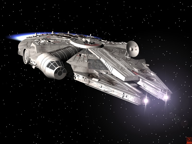

Hi!
Do you guys remember my old Falcon-model?  I made a new one.  Started right
after Ryan Constantine posted his first version of his X-Wing.
The model isn't finished yet.  The quad-laser cannon and the radardish are
temporay objects (just copied from my previous model) and there should be
some pipes from the radardish to the left mandible.
And some colors aren't entirely right.
And (I almost forgot) it has no detail on the bottom.
No bump_maps used.  Everything you see is real.
Anyway...  Comments are welcome!
Oh, yeah...  The stats:
2619 frame level objects
Peak memory used: 9602538 bytes
Time For Parse: 3s
Time For Trace: 4h 40m 14s
GUI-priority: Highest
Render-priority: Lowest
On a PIII 450 with 64 MB RAM under W98SE
ZK

Too shiny.. cut down whatever you're using for highlights. (And/or make
it so that the dirty parts don't have as much highlighting.) Also, the
glare on the front looks decidedly un-SW-like.
Aside from that, though.. it's a VERY impressive model. :D
There are no highlights, except on the glass of the cockpit...
But...  My light source has an intensity of about 1.5
Maybe I'll change that, but I'm not sure that's really necessary.
Yeah, that's right...  Should be more yellowish and simpler.
Tnx!

Under 10MB memory used... try this with polygons and see if that number remains low!
Fabulous job of it.  Animated in a action scene this detail would suffice pretty well,
don't you
think?
The texturing seems alright to me.  It wasn't always so dirtied up if I remember the
movies enough.
Was different during battle parts compared to what it looked like in the Death Star
hangar I
thought.

good job!  care to share textures?  it might be educational.  what did
you use as a guide?  what scale are you using?  my xwing is 1 unit = 1
meter which makes the length 12.5 meters.  i have the falcon model and
thought about doing this too.  how much more detail are you going to
add?  did you use a modeller?  is anything animatable (landing gear,
radar dish, laser cannons, engine thrust, top hatch, main door)?  is the
top surface actually divided into many seperate plates?  is that how you
got the localized dirtiness?  i've started working on r2d2 as well as
planetary (or death star) explosions.  i also plan on modelling the
death star (using sets like the movie; close, far, trench).
> Time For Parse: 3s
how did you get your parse time so low with so many objects in the
scene?  are there any meshes or patches?  my current object count is
over 1300.  you've got double that but mine takes 15 sec to parse.
hmmmm...

>  It wasn't always so dirtied up if I remember the movies enough.
no way.  it was the dirtiest ship of the movies.  the "fastest
hunk-a-junk in the galaxy".  the model needs to be dirtier.

Do not recall the old but this is  nice... The texturing looks good but could
use some tweaking... Some of the dirty/rough spots look off...?
I like it... Keep going...
Hand code...?
could
You can see the old one on my site.
Maybe...
I don't know.  That's a hard part :-)
Tnx
> Hand code...?
Completely hand-coded.
ZK
http://www.povplace.be.tf
remains low!  ;-)
It shouldn't be too hard to convert this to polygons.  I just have to make a
height_field out of it.  There is a post-process filter that does it.
pretty well, don't you
> think?
Hmmm...  4h per frame...  That's a lot of time.  Even at 640*480 it still is
about 3h per frame.
Death Star hangar I
> thought.
The model used in A New Hope was much cleaner than that one used in The
Empire Strikes Back.
Unfortunately this was supposed to be a reproduction of te TESB-model.
> Bob
ZK
I know, but it's not that simple to do!
ZK
When it's finished, I'll share the source.
I used The Essential Guide Te Vehicles And Vessels and *lots* of pictures
found on the net.  I don't really know what scale I'm using.  The same scale
I used for my previous model, but I don't think it's an easy-to-convert
scale ... :-(
Length is a problem with the Falcon.  Some say it's 28m, some say it's 35m
or anything in between...
Purely hand-coded.  Nothing is animatable right now.  There is no landing
gear and the radar-dish is temporary (but a bit animatable).
The laser-cannons are temporary too.  You can set the brightness of the
engines thrust.  The tophatch is not animatable.  Maybe in the future.  The
maindoor isn't even modelled yet.
The armor-plating is there, yes.
Yep.  I used an image-pattern for it.
Wow.  That's a good idea!  Looks like StarWars: The POV-Ray Collection is
going to live again!
All CSG.  No height_fields, no isosurfaces.  I don't know how it can be
parsed so fast.  I don't really care, actually :-)
> hmmmm...
Strange...  Maybe becaused I used a lot of loops and some macros (for the
armor plating)?
ZK
> > hmmmm...
> armor plating)?
The difference in parse time could easily be due to the fact that Ryan
has used patches for the main hull of the X-Wing.  Depending on the
subdivision settings used, patch objects can take ages to parse (I speak
from experience :)
I could be wrong, of course <grin>
Bye for now,
     Jamie.

This is a wonderful model.  The only beef I've got is with the lighting.
Let me share a secret with you.  The secret to great lighting is to *never*
(and I do mean never) put a main light *anywhere* near the camera. This
mistake is what makes those newbie 3DS and Lightwave rendering look so
crappy.Here is what I suggest.
FaintFillLight		Main Light
	Object
Camera
This is a top view of a lighting scheme that works pretty well.  The faint,
"fill" light (try <.2,.2,.25> and shadowless) would be at your current main
light location. Take the main light you have now and move it over to the
other side of the model.  Also, bring it closer to the front.  You can even
leave the intensity at 1.5.  Or, alternatively, you could change the
intensity to 1 and make a .5, shadowless, light at the same location.  This
will give a slight radiosity effect with no render overhead.
I'm sorry if I sounded preachy, but this is the single lighting mistake
that bugs me the most.

Actually the main light is *very* far away :-)
Don't worry, I don't make such mistakes.  I know that a sun is very far
away.
It's the intensity of the light that isn't good.
Wait a minute, I'll answer in your text :-)
H. E. Day <Pov### [at] aolcom> schreef in berichtnieuws
01bfee6e$85828540$107889d0@daysix...
> Zeger,
Tnx!
*never*
Wow, a secret, always nice :-)
I know.  I do this only when testing my objects...
Hmmm...  Are you saying this render looks crappy?
> Object
> Camera
Wait a minute... You put the main light on the other side of the model...
That way the camera is looking at an unlit side...
That's quite dark, isn't it?
faint,
main
Ah, like that...  I have fill lights, but they are on the other side. (and
also very far away :-)
even
This
Good idea.  I'll try this.
np
Always nice to hear some comments from an expert.  Even when they aren't all
that positive.
You see: I rather hear you say it's crap when you mean it, than say it's
good when you don't mean it.
> H.E. Day
Here's an idea: I give you the model and you turn it into an awesome image.
Whadayasay?
ZK

My opinion is to use only a total of rgb 1.5 in lighting on any one surface,
and that means any shadowless fill light counts as being shone upon all
surfaces.  Unless of course you are trying for an extrordinary effect or
something.
By saying "total" that would be like 4 lights of color rgb 0.125, rgb 0.125,
rgb 0.25, and rgb 1.0 for example.
From: ryan constantine
Subject: Re: Millennium Falcon
Date: 15 Jul 2000 23:10:53
Message: <39712775.8A18D732@yahoo.com>
what do you know, that's pretty much the way i lit my last scene.  i
used light groups via megapov.  the sun was the main light and affected
all objects.  and there is a fill between the planet and the xwing that
only affects the xwing.  i've studied photography a little and i
recommend it to anyone creating images in any medium.  your advice is
sound mr. day.  however, model showcases are the exception to this rule
of thumb wouldn't you agree?  scenes deserve great lighting but when
showing off of models there should be enough light to see by.  because
of the stars, i'd say this was a scene.
"H. E. Day" wrote:
> Zeger,
>         Object
> Camera
> H.E. Day
Date: 15 Jul 2000 23:16:29
Message: <397128C4.AEBEDCEE@yahoo.com>
oh, and i always use radiosity for final renders.  if you think the
underlying color of my xwing isn't white enough (and if you look at the
texture in moray it is very white), you should see it without radiosity.
besides, the shadows just seem better to me than low-intensity fill
lights do.

Most excellent... My applause... I wish my hand codes were as detailed as
you have done here... =)
> Tnx
> > Hand code...?
> ZK

Zeger Knaepen wrote:
> > You could always just try to imagine it is in an action scene then.  Or
> use a
> > tiny, microscopic, resolution.
> Or let it render while I'm on vacation.  When I come back (2 weeks later)
> I'll see it has finally reached frame 10 of 100 :-)
> > Bob
> ZK
From: Zeger Knaepen
Date: 17 Jul 2000 07:10:55
Message: <3972e9bf@news.povray.org>
Moon47 <rdm### [at] earthlinknet> schreef in berichtnieuws
39713596.7DE43352@earthlink.net...
> In 14 days you should get about eighty frames done at 4hrs/frame...
> Try 320X240... Usually makes a good movie size...?
You've actually been calculating it? :-)
How bored can you be :-)
320*240 is small.  I would go for at least 400*300.
But you forgot one thing: when doing an animation, it would probably fly
close by the camera.  A close-up won't render that 'fast'.
But, then again: there would be frames where the falcon looks like 2 pixels
ZK
