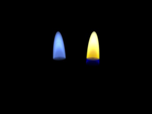

Hi all
I spend most of last night playing with fire (not literally)
I've got a fairly decent candle flame, so I thought I'd post it.
I'm not totally happy with the shape (difference between
streched sphere and unscaled sphere)
Main media consists of a gradient y density and a spherical
density. There is a second object at the bottom to create the blue
glow.
Comments? suggestions??
Gail

How about showing this on a white background?  Sorry, I don't really mean that
Candle flames are always much more of a yellow-white than just yellow, I know
everyone seems to not believe that though.  Also varies a lot depending on the
surrounding light and background, but I still always try for a near white
yellow which goes to yellow-orange at the edges and top.
Turbulence is another thing, sometimes there's none sometimes a lot.  As far
as the general shape goes I think you've come close enough but I'd say there's
not enough blue (or rather invisible) part going up inside the yellow part.
The amount of the merging parts I'm talking about, maybe more diffused boudary
line there would be better?
I found this photo: http://www.hd.org/Damon/photos/_I/cat/lw/eooz2q1mh6.HTM
and it has no blue base to the flame!

Very nice, but IMHO looks more like a match-flame.

Bob Hughes wrote in message <396c532b@news.povray.org>...
that
It disappears completely on a white background :-<
know
the
I had a candle burning on my bookshelf while modelling this. I'll agree that
the tip
was more white (tried but couln't get that effect) but most of the candle
flame
was yellow/orange
far
there's
boudary
Between yellow and blue? I agree, at the moment they're different objects.
Gail

The blue should have a shape that looks like a rounded / \ or something :P
but otherwise it's really good : )

If it was mostly blue it would look very much like a gas flame. I like it.
Alan

if you use a color map in your spherical density, you can include all of
the necessary colors.  and are you using multiple densities, or multiple
medias?  there is quite a difference between them.
Yup, I know. Multiple densities. I needed another object for the blue as it
was outside of the container object of the rest of the flame.
The spherical density creates the darker patch at the bottom. The gradient
density creates the colours.
Gail

Alan Nickerson wrote in message <396c66ff$1@news.povray.org>...
didn't think about that, but you're right. I tried a gas flame (with no
source of reference for the colour. It's been 3 years since I last
used a gas flame)
I also played a bit more with the original flame. Not much better
Gail

Add an Absorption colour which is the inverse of your emission colour,
and it should show up on white backgrounds...
This means, if you have an emission of rgb< 1, 0.2, 0.152 >, the
absorption should be rgb< 0, 0.8, 0.848 >

Mmmmm nice flame, looks much more like a cigerett lighter flame
in shape and distribution of colour, but maybe the yellow should
be more white and more red than it is (what I probably mean is
the yellow section needs less green in it).

This amoung the best candle flames I've seen so far. Keep up the good
work.
Tsk. Add an absorption color that is the inverse of your emission
color _and_has_the_same_brightness_ . Try something like this:
#macro Brightness ( Color )
  0.3*Color.r + 0.59*color.g + 0.11*color.b
#end
#macro Inverse_Color ( Color )
  #local Jamie_Inverse = <1,1,1>-Color;
  Jamie_Inverse / Brightness (Jamie_Inverse) * Brightness (Color)
#end
I hope it works, my newsreader isn't the best way to try out POV code

On Sun, 16 Jul 2000 02:09:25 +0300, Peter Popov wrote...
> On Thu, 13 Jul 2000 20:47:13 +0100, jam### [at] dh70qdu-netcom (Jamie
<snip>
That would explain why I've only had limited success playing with
emitting media on white backgrounds.  Ta.
Mind you, I've not really played that much with media in any serious
manner.
Ah well, that's another piece of (useful) trivia to try and file away in
the POV related section of my brain...
Bye for now,
     Jamie.
