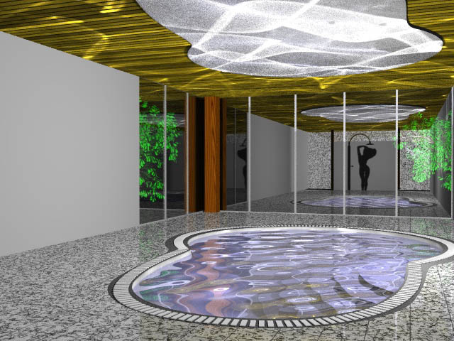

Hi all,
Attached is a picture I made a few weeks ago with MegaPOV. I like the
pool and girl, but I don't like the room. The picture missess some,
there should be something inthe background, but I have no clue at all
what. Any suggestions are welcome. The trees are made by Neil Alexander
for one of his IRTC entry (nature).
Thanx
ps. YES, she IS naked :)
Download 'pool5.jpg' (81 KB)
Preview of image 'pool5.jpg'

Thomas van der Veen wrote:
> Hi all,
> pool and girl,
The pool is great, so are the reflections on the ceiling !
The girl, well, she is not my cup of tea ... :-)
IMO the left wall needs some structure, you could add some plant in a
pot, the tree(s?) look a bit blurred.
Have you tried the mirrors not in a line but in slightly cylindrical
form?
I'm not sure about the effect, but I think it's worth trying.
From: Thomas van der Veen
Subject: Re: Pool image (81Kb)
Date: 15 Jun 2000 12:29:40
Message: <39490385.6A8F8E06@gmx.net>
The reflection on the ceiling are photons.. took a few hour, but who cares :)
I have  been thinking about that, actually I would like to have some kind of
small tree next to wall, but I have know clue how to make a tree that doesn't
interfere with the wall.
> form?
You mean in a round shape  (half round) I have thought about it but I haven't
tried, I may try that some time.
> Christoph
Thank you
From: SamuelT
Date: 15 Jun 2000 12:40:04
Message: <394907B9.198B6912@aol.com>
Perhaps a small metal table with drinks on it would look good next to the
pool. Maybe a skylight would be good to draw more light into the scene. A
towel rack might be another thing you would see next to a pool.
The pool itself is excellent. How did you get the bricks to follow the edge
like that? The woman looks good as well.
> Hi all,
> Thanx
> Thomas
From: Hartmut Wagener
Date: 15 Jun 2000 20:38:15
Message: <394976f7$1@news.povray.org>
The nicest thing is to think that the girl is close to the watcher ...
The walls could be more textured (Kachel (german), what is the english word
for this?).
Thomas van der Veen schrieb in Nachricht <3948F0A2.EA401BF7@gmx.net>...
>Hi all,
>Thanx
>Thomas
Date: 16 Jun 2000 00:07:50
Message: <3949a816@news.povray.org>
"Hartmut Wagener" <har### [at] arcormailde> wrote in message
news:394976f7$1@news.povray.org...
| for this?).
The Babel Fish tells me kachel is "page frame", sounds like a html thing to
me.
I was thinking the walls were too much of a neutral gray.  You usually don't
see such walls unless it's a prison, well maybe not these days though.
From: Vahur Krouverk
Date: 16 Jun 2000 03:21:30
Message: <3949D615.E56CF02@aetec.ee>
> Hi all,
Try to play with lightning. Now it is lit too uniformly (look at this
wall in the left). I'd suggest spot lights in various directions, which
will make it more hmm, "romantic". Or try to decrease ambience.
HTH
From: Marc-Hendrik Bremer
Date: 16 Jun 2000 04:21:24
Message: <3949e384$1@news.povray.org>
Tiles - my Langenscheid-dictionary says.
Hartmut Wagener schrieb in Nachricht <394976f7$1@news.povray.org>...
>for this?).
Date: 16 Jun 2000 04:37:55
Message: <3949E66F.B5D0D54@gmx.net>
The bricks are done with Chris Colefax Spline include file. It took a lot of
testing to get it right. I would like to do the cut out on the floor tles that
way as well, but I haven't tried it yet. Thanks for the suggestions.
From: Alan Kong
Date: 16 Jun 2000 07:34:58
Message: <j04kksssre103bvudnqbfbfq845gi0nn6m@4ax.com>
On Thu, 15 Jun 2000 16:05:06 +0100 Thomas van der Veen
>there should be something inthe background...
<snip..>
  Hi, Thomas. IMO you might put something in the foreground near the
blank wall. There aren't enough shadows in this scene to reference where
the light source is. You might place another tree or possibly a
sculpture of some sort adjacent to the wall to balance out the picture.
To me, the rest of the scene looks good, especially the pool and the
ceiling caustics.
Alan - ako### [at] povrayorg - a k o n g <at> p o v r a y <dot> o r g
http://www.povray.org - Home of the Persistence of Vision Ray Tracer
From: Bas Leerintveld
Date: 17 Jun 2000 10:10:28
Message: <394b86d4@news.povray.org>
Maybe you should put a painting of some sort on the gray wall (besides some
texturing), maybe something you've rendered before :-D
hmmm, or a sculpture, as Alan Kong suggested, something classical; Milo's
Venus e.g. ;-D (have fun modeling that one!)
And maybe you should try to make the floor look wet?
Best regards,
Bas Leerintveld
_______________________________________________
Bas Leerintveld - Bivak:
Bivak Internet: http://www.leerintveld.demon.nl
From: CreeD
Date: 20 Jun 2000 10:49:32
Message: <01bfdac7$7e102e80$9f1ba1d0@mk>
The light on the ceiling effect is neat.
Maybe have the gray area on the left be an opening with some columns into
the outdoors? Possibly at night?  The addition of some moody lighting from
outside would be nice.  And maybe a less busy floor texture.
From: Ken
Date: 28 Jun 2000 21:21:11
Message: <395AA393.E6E23608@pacbell.net>
There is a Venus statue available at the POV-Ray objects collection
that I donated a year ago. It has a lot of smoothing in the triangles
and is reasonably small in size (for a mesh based object) -
http://povobjects.virtualave.net/
