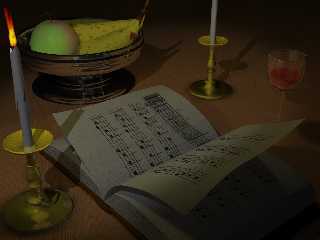

Hmm ... something is missing ...
I know the fire looks odd ... The lighting att all is far away from beeing
perfect ...
BTW: now imagemaps used (except for the pages) all textures are procedural
 ,',    Jan Walzer      \V/  http://wa.lzer.net     ,',
',','   student of      >|<  mailto:jan### [at] lzernet ',','
  '   ComputerScience   /A\  +49-177-7403863         '
Download 'notes.jpg' (89 KB)
Preview of image 'notes.jpg'

Looks pretty good but what's up with the top of the music? Is it
supposed
to be floating above the page?
And here's my nitpicky music comments, Skip this part if you don't
really
care about this sort o' thing.
There's no time signiture, it looks like this should be in 4/4 with
more bars added after every fourth quarter-note, but if that's the
case then the there should be one more half-note at the top(there's
currently 7 unless I can't see one). Also the half-note with the stem
going down should have it's stem on the other side. There's also no
indication for tempo.
...like I said, nitpicky. :)
Phil

Noch leben, I think it must be, according to the Babelfish anyway.
Is there a light source at the position of the candle flame(s)?  And if so is
it white light?  Reason I ask is because there doesn't seem to be any and no
yellowish coloring from there.  But then you have said here it wasn't right
somehow.
Good job on the fruit bowl.  I was thinking you could have used the music true
type font Ken Tyler had a while ago if you haven't already.
The candle wax is very neutral gray, if they were intended to be regular white
wax then they don't look it.  A colored wax might be good anyway, something
like red or yellow or blue, whatever.
> supposed
Yes, you're right ... the 1st line was intended to "fly away" ...
> really
I know the music itself is quite primitive... I don't hope someone here
tries to play the notes ... I'm sure it will sound very odd...
I'll do some changes, based on your comments, but the whole image was
currently only intended to be a concept ...
For a final Image there would be much more changings neccessary... not only
the correctness of the music ...

ok, firstly as you noted the lighting is all wrong, it dosnt even look like
the candles are emmiting the light, try placing scaled area lights (3x1
vertical strip) inside the flames (and set the flames to no-shadow), then
maybe use a fill area light above and behind the camera to brighten things
us a tad.
rip the floor plane out and use a box (or box shaped super elispe) even if
the far edge is only just visable it will look better
apple & narna look good - nice texturing :)
make the candles pure white, and the book texture needs lightening up -maybe
loose or lessen the bump map - looks more like that lumpy wallpaper
maybe move the wine glass more central so it looks part of the scene (dont
forget thos caustics - photons!)
candle sticks and bowl are very nice - dont mess with them yet!!
the wood texture needs to be scalled up slightly, even if it looks larger
than it should be it will look better
as always if i come across a bit strong, i would expect no less of my own
images (carnt abide damn faceless 'yes' men)
