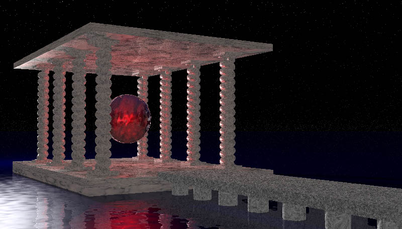

Once again, just fishing for opinions, suggestions, critics, etc etc

I've wondered if you are not able to post a single message with attachment.  Didn't
notice if anyone had mentioned this before about multiple posts such as yours, that
it's
not the usual way and all.  I can set this newsreader (OE) to do either way but it
seems
cumbersome to separate the text from the image(s).
The rendering is going well, I think it has too much ambient in the stone parts but
that's common for it to be either too much or too little.

I am re-rendering the image as we speak, (so to speak, hehe), I have
included another light source, to the Right hand side, and toned them
both down a bit, so they are not FULL brightness.  Also, i turned on
focal blur for the camera.
The one question I have, Its not cheating to use Moray to create
portions of the scenes is it?
Thanks,
Dave

What are good settings to use for Focal Blur?
Right now, i am using:
camera {
  location  <     44.300,      93.000,       5.000>
  sky       <    0.00000,     0.00000,     1.00000>
  up        <        0.0,         0.0,         1.0>
  right     <    1.81060,         0.0,         0.0>
  angle         43.61300    // Vertical      24.922
  look_at   <    -10.900,       5.100,       8.400>
  focal_point  <-10.900, 5.100, 8.400>
  aperture     1.0
  blur_samples 100

To answer the other question, no, I don't call Moray or any other modeler a
cheat when POV-Ray is ultimately the ray tracer.  I do call it a skill I lack
a lot of, me being primarily and almost exclusively a pov file script writer
"Dave Rich" <est### [at] jetcablecom> wrote in message
news:dbqbjsstscno6ji74910iblq5ug2crr7sf@4ax.com...
| camera
|   up        <        0.0,         0.0,         1.0>
|   aperture     1.0
|   blur_samples 100
|   confidence   0.999
|   variance     0.0001
Those are high quality settings there, I often use much less than the best in
order to reduce render times.  I'm talking about the variance most because the
aperture is the amount of blurring which is scene dependant.  I'd say aperture
0.5 goes well for most typical scenes 1.0 and above become more like
telescope/binocular/microscope focuses.  But it's subjective to the artist.
You might see others here have differing opinions/advice.
The samples is 2nd most important I'd say, next to aperture.  And since all
this is so CPU clock-speed dependant as well then I'd suggest using a number
half your CPU MHz and go from there (likewise in variance as in 1/250 for a
500MHz).  Btw, confidence doesn't appear to be as notable of change in quality
and speed I think.  A value of 1.0 would do fine for the most part since the
default of 0.9 makes little difference.

Water looks nice. Some antialiasing would probably do wonders for the
stone, though.
Xplo Eristotle

I like the image directly before this so uncluttered... But this is good
all the same... I think a shooting star behind the pillars would be
nice... The marble could stand to be more smooth and shiny like the
water...?

How did you make the spiral column

Looks pretty cool, the water looks great.  It might help if you toned down
the ambient light.  A little less ambient lighting would bring out some
shadows and create some nice contrast around the pillars.

There are a few purists out there (myself being one of them) that will not use other
programs
for modeling. Even I have my exceptions, using a Poser .dxf file and a height feild
pulled
from a DEM datafile in one image.There is nothing wrong with using a modeler. That's
what
they're there for.

i agree about the antiliasing. it would do wonders.
I would guess that he did it with the columns plugin for Moray.
Sorry, I don't have the URL, but I think it's somewhere on the Moray
website - http://www.stmuc.com/moray

No, it just shows that you can use a good tool to help recreate your
artistic ideas better than those of us, me included, who can not.

There is a Column plugin for Moray.
The address to it is:
http://www.users.zetnet.co.uk/keithh/columns.zip

You could also do these columns with Chris Colefax's spirals include file.
Saadat Saeed wrote in message <39363F44.BD56F03B@batelco.com.bh>...
