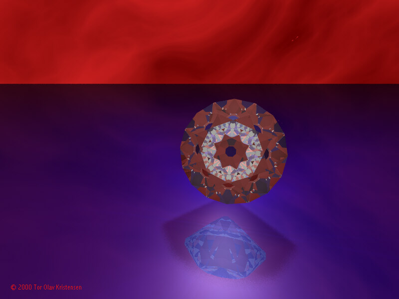

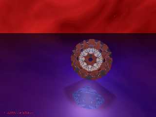

Sigmund's diamond image inspired me to do
some more work on my old diamond shape.
At the time I made it I was quite tired of
trying different light settings and interiors.
(Round brilliant at my web pages.)
This time I looked at Sigmund's texture and
interior settings. Thanks Sigmund !
The diamond in this image is viewed from
"above".
I'm not sure yet if my diamond shape is so
"ideal cut" that the reflections through
the crown makes the "right" light patterns
when viewed from this angle.
Does anyone know ?
My 100 MHz Pentium PC needed 3.5 hours to
render this image.
Tor Olav
mailto:tor### [at] hotmailcom
Download 'diamond01_02.jpg' (50 KB)
Preview of image 'diamond01_02.jpg'
From: Sigmund Kyrre Aas
Subject: Re: Crown of diamond (50KB)
Date: 27 May 2000 12:39:15
Message: <392FF9F0.C7AACCD0@kyrre.net>
Glad I could be of some inspiration!
Although interesting, I don't think the viewing angle is the best. I see
what you mean about proporsions now. I really don't know how a diamond look
apart from a tiny 2d-pic. Anyone know how much brilliant diamonds can
differ?
sig

From: Tor Olav Kristensen
Date: 28 May 2000 00:06:55
Message: <39309846.7952272D@hotmail.com>
I'm willing to agree that picturing a diamond from above not
necessarily is the best way to show off a diamond shape.
But the diamond shape is designed so that as much light
as possible is reflected out of the crown. And of course
people therefore prefer to have the diamond mounted with
the crown "up" in their jewellery.
> Anyone know how much brilliant diamonds can differ?
The diamond cutters often try to cut the diamonds so that
it looses as little weight as possible to in order to get
high carat numbers.
This causes a lot of round brilliant diamonds to wary
quite much from the "ideal cut".
Here's a couple of pages that I found about diamond cuts:
http://www.accurateappraisal.com/idealcut.htm
http://www.anstett.com/diamonds/aboutdia.htm
http://www.geocities.com/Eureka/Gold/7365/cut.html
http://www.professionaljeweler.com/archives/articles/1998/jul98/0798dg.html
http://www.professionaljeweler.com/archives/articles/1999/jan99/0199dg.html
http://www.tradeshop.com/gems/diamond.html
http://www.accurateappraisal.com/willthe.htm
http://www.gemex.com/bscopeapplet/index.html
http://www.eightstar.com/
Tor Olav

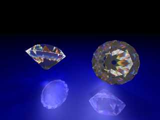

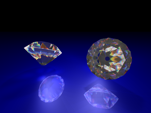

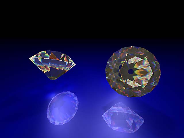

From: Børge Berg-Olsen
Date: 29 May 2000 02:47:05
Message: <3932117D.70B9DF79@dod.no>
> Does anyone know ?
I does not look like it is an ideal cut. It seems like there is a "hole"
in the culet of the diamond. This hole should not be there. See attached
image. I played with photons and dispersionsettings until I was happy.
What do you think?
> render this image.
Uhm, I'm not sure if I should tell you this, but my PIII 650 Mhz took 24
minutes to render ed this image...
Børge Berg-Olsen
  +47 90 62 71 78          DoD#2101, DoDRT#017, NIC#015, PJ#006, OGM#007
  azo### [at] dodno, Ducati M600              Ubesudlet: Aldri eid en J&%#PS.
Download 'crown_of_diamond_large.jpg' (30 KB)
Preview of image 'crown_of_diamond_large.jpg'
Date: 29 May 2000 07:05:12
Message: <39324EAC.5A5ECB87@kyrre.net>
Steve wrote:
> I've started to render this, but can't get any photon effects.
> If someone could alter the code and add the photons and repost
> the code in p.b.sf or p.t.sf I'd be glad to render it.
Try scale 3 on the diamond. Photons seems to dislike small objects.
In addition I have this:
global_settings {
    photons { count 10000 autostop 0 max_trace_level 50}
    max_trace_level 55
Variable reflection looks good, but is much slower than regular reflection.
I've also abandoned dispersion and attenuation. i.e. not much fun left :/
sig
ICQ 74734588
Date: 29 May 2000 07:05:15
Message: <39324EF6.DF6CC853@kyrre.net>
Pøh, no AA. (just jealous.) I've noticed it has a flat tip; I think that's
what causing the hole. I guess it should have a flat tip since Tor Olav
obviously has done good research on this.
The dispersed light has a strange dirty look. Not sure I can see photons
either.. I guess an ior of 2.4 spreads light a lot so you may want to place
the diamonds closer to the floor.
Just noticed: this scene uses fade_power 1000; that is to turn on a new
attenuation formula in MegaPov. Official Pov should use sub 2 fade_power.
I'm surprised of the speed. I made a triangle mesh for my diamond because I
thought csg would be slow.
sig
ICQ 74734588
Date: 29 May 2000 22:44:18
Message: <39332047.BFE121B2@hotmail.com>
My understanding is that the small facet at the
bottom of the diamond is called the culet.
There seems to be many opinions about what is the
best cut for a brilliant diamond.
I now think that I made the culet a little too big.
To make the culet facet smaller one would have to
increase the 8.2 value a bit in the plane { -y, 8.2 }
statement in the Brilliant declaration.
To remove the culet facet, just delete this plane
statement.
If the culet is made smaller or removed, then the
-8.3 value in the bounded_by statement in should
be lowered (more negative).
When I made this diamond shape, I spent much time
searching the internet for information about the
geometry of diamonds.
I found most of the data I needed, but there were
some data I could not find back then.
Therefore I'm not yet sure if all the facets are
"right".
> See attached
> What do you think?
Thank you for rendering it with photons.
Now I'm sure that I like Photons very much !
I especially like the "fire" that appears
within the diamonds in your rendering.
I'm curious about how the code looks now.
Could you please post the code with your
modifications for Photons ?
I read that Sigmund suggests placing the
diamond closer to the floor to see the
Photons.
Maybe it would then be wise to lower the
reflection value for the blue "ground"
plane so that the reflected diamond image
does not destroy the caustics.
Subject: Re: Crown of diamond [150kb]
Date: 30 May 2000 16:06:44
Message: <39341E56.33456085@dod.no>
Yes, you're right. I didn't study the drawings and descriptions closely
enough.
I does look like it is a little bigger than it is supposed to be, yes.
Also, a brilliant cut diamond is supposed to have 58 facets, and not 74
facets as in your diamond?
Your welcome, I've traced a new version with radiosity and a little
different settings.
The fire is caused by a dispersion setting of 0.75 in the interior
statement.
But of course.
There are some caustics visible with the current settings. Have a look
at the attached image.
Børge Berg-Olsen
Download 'crown_of_diamond_smooth_large.png' (146 KB)
Preview of image 'crown_of_diamond_smooth_large.png'
Date: 30 May 2000 16:11:03
Message: <39341F60.D8060BF5@dod.no>
Yes, I was wrong, he is right ... the tip should be flat, but it is
exaggerated in the model.
I belive that the dirty looks comes from the pigment settings of the
diamond texture. I tried to set it to rgbf <1.0, 1.0, 1.0, 0.95> to see
if it improved things, but I will not know before another ... ohh, 20
hours or so. :-) If I bother to trace the image.
Well, the quality settings weren't that good. The last image I traced,
the one with radiosity, took about 22 hours.
Børge Berg-Olsen
