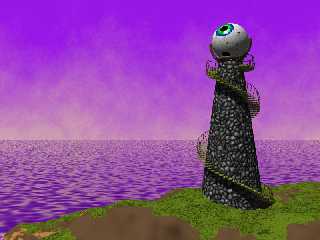

As a part of my "publish-those-old-images" program I found this image I made
about a year ago. Back then I lost interest for it and never came around to
publishing it. However, when I recently looked at the image again, I though
it deserved to be published. I made a few adjustments, and this is the
result.
What do you think of it? Does it need improvement? The image is supposed to
be kind of surrealistic. Does it qualify? Maybe I should add a strange
flying thing far away in the sky. All feedback is appreciated!

Needs media...

For what? Atmosphere?

Yup. You could also shroud the tower with some emitting media of some sort
to give it a magical quality.
Subject: Re: Eye Tower
Date: 30 Apr 2000 16:00:27
Message: <390C9042.1176B11E@faricy.net>
It seems lacking. I would suggest adding some detail to the textures, and fix
the lighting (the tower looks almost flat). Perhaps Tony was right about
media...
With the tower perhaps you could take the equation for a cone (it is a cone
isn't it) and add/subtract the crackle pigment function and make it an
isosurface so the sides are not flat (contained_by a elongated cube/box)
Apart from that its pretty good
Pabs
I don't think I'll do that, but I'll try out atmosphere. :-)
> some detail to the textures, and fix the
> Perhaps Tony was right about media...
Thanks for your suggestions, I'll try it out.
That would be my first isosurface...
Well, I'll try to learn how to use it... :-)
See http://members.aol.com/stbenge/ for a tutorial (good one) & there
was another somewhere but I can't find it anymore
http://www.econym.demon.co.uk/isotut/

"TonyB" wrote:
> Needs media...
> some emitting media of some sort to give
> out atmosphere. :-)
"Chris Huff" wrote:
> Atmosphere?!?
Did you think I meant the old POV-Ray feature "atmosphere"?
I meant atmosphere made with media of course... :-)

"Pabs" wrote:
> > it... :-)
> a tutorial (good one) & there was
> anymore
Thanks! (And thank you too Ken!)
I used an isosurface with a crackle function, and it did indeed look better!
Still much work to do though, so it may take a while before I post a new
version...

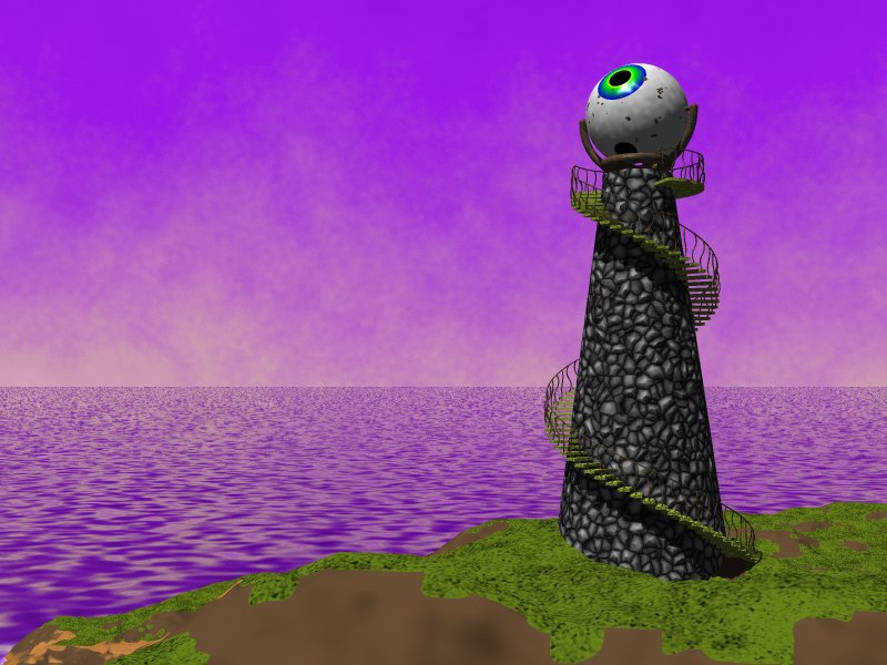

     Have you still got the image Rune? I'd be interested in it.
The image or the source?
Well, I've got both, but now I've gotten interested in it myself, and I
might work some more on it before publishing anyting... :)
I'm thinking isosurface tower, realistic grass, and other things...
