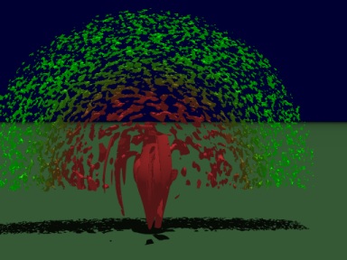

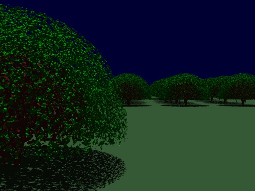

I've seen some tree makers here which are breathtaking in their visual
beauty.  I think that the coolest alorgithm for a tree, however, would
be procedural and not involve lots of translate & rotate statements.
Here's my first stab at a procedurally derived tree.  Further
experimentation underway.  Feel free to take this and improve it.
#declare rag=function{ 1/(x^2+y^2+z^2)^0.5*5}   // 35;
#macro Treegent(gent,tx,ty,tz)
//gent is currently useless randomizer,  translate to tx, ty, tz
union{
 isosurface{
         function{
noise3d((x+gent)/rag,(y+gent)/rag,(z+gent)/rag)&(-y-1) }
                accuracy .001
                threshold  .01
         contained_by {sphere{0,15} }
         bounded_by   {sphere{0,2 } }
 isosurface{
         function{  noise3d((x+gent)/rag,(y+gent)/20/rag,(z+gent)/rag)}
                accuracy .001
                threshold  .08
         contained_by { sphere{0,5} }
         bounded_by   { sphere{0,1} }
 pigment{
         spherical
  pigment_map{
                 [0      Green]
                        [.2     Brown]
                        [1     Brown]
                scale 12
        finish{ambient 0.1}
        translate <tx,ty,tz>
  #end
Download 'noiseforest2.jpg' (62 KB)
Preview of image 'noiseforest2.jpg'

    Not too shabby! Looks like an Orange Grove.
    I haven't tried to play with your code yet... looks like fun...

From: Greg M  Johnson
Subject: Re: Towards a procedural tree macro (62kbbu)
Date: 26 Mar 2000 12:47:10
Message: <38de4d1e@news.povray.org>
I chose the noise3d function because it has its own 'branchability' built into
it.
See the following image, with a slightly higher threshold, and a cross section
through the branches.
