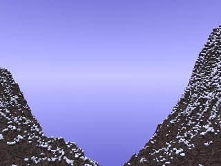

Strange, I was working on a blob-text macro at the w.e. and two pop up in
this ng. Anyway, got sidetracked by an alternative use - blob snow on a hf.
To some extent the macro mimics TRACE type 2, in that height and normal of
underlying hf is a factor. The main problem at the moment is trying to
remove all traces of regularity from the blob placement.
Download 'testmounts.jpg' (17 KB)
Preview of image 'testmounts.jpg'

This has real possibilities - trace type 2? I missed that one - have to look
it up. perhaps scaling the blobs flatter would help with realism.
I think that handling randomness in pov is really difficult to control -
IMHO it's an area that could be improved.

Sorry, meant to say "slope type 2", not trace. Yes, tried scaling the blobs
flatter, but I think it made them overhang in a weird way. I'll try it
again, though, as I've added some new parameters I can play with since then.
I've posted the code in text.scene-files if you want to take a look. (not
the tga - if anyone wants it, mail me).
You could try declare a pigment and use eval_pattern or eval_pigment. Put
it in inside your trace loop. If the value of eval_pattern is higher than a
given value trace the point, if not go to the next point.
Ingo
Scale them flatter but also rotate them to the normal of the slope.  This should
fix any problems.

Tried that - failed miserably to work out how to do it - I have a normal,
how do I translate it into a rotation? Many thanks in anticipation.

Tom Melly wrote in message <38d81927@news.povray.org>...
>H.E. Day <hed### [at] fcinet> wrote in message news:38D80551.3BD86960@fci.net...
>should
>> fix any problems.
Try using the 'reorient' macro on the normal vector and the 'y' vector to
get the transform you need.
Mark

looks like a moutain of golf balls

Yeh, those japanese golf courses are a bitch...
This is has become much better with megapov.  You can try vturbulence() or, for
more control, eval_pigment() or eval_pattern(). All these functions may provide
"intelligent" randomness, i.e. randomness who knows where it is and what it
does.

Bingo! Looking good, many thanks. Will repost the results.
