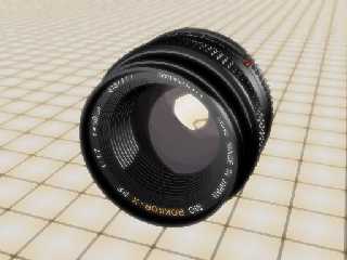

This is the first iteration of this render. Done in MegaPov 0.4...  Still
lacking some calibration marks around the circumference of the lens barrel,
and have yet to incorporate any reflection_blur or radiosity... comments or
suggestions welcome. I plan on eventually rendering the entire camera.
Download 'the_lens.jpg' (34 KB)
Preview of image 'the_lens.jpg'

i was looking at one just the other day and noticed that the protective glass
has a purple oil on it or something also maybe for reality sake this is over
exposed and it's in too good of condition.. perhaps some nicks and screeches as
well maybe a better floor and the rest of the camera would help..... :) in the
end try putting some kodak film or something by it too. i can see this going
places. great work.... but i could do better... just kidding :) photons if
there arent any
is the refraction in the glass looks wrong

That's not oil, it's the antireflective coating. It works by an
interference process, similar to iridescence. It causes the reflected
light to be dimmer and purpler than would be expected for that type of
glass. I suppose the refracted light thereby becomes very slightly
yellower.

...it does indeed work by an interference process, and it is indeed the very
process we call iridescence... although the
incoming (refracted) light remains largely unaffected, as the multiple
glasses inside the lens seem to cancel each other's color out.
unfortunately, said process in POV (or MegaPov, AFAIK, cannot be accurately
rendered. I'm going to try a reflection_color and see if that works. In
response to several other responses... yes, it WAS hand-coded, although I
have since remodelled it in Moray, as the camera body is proving
signifigantly more difficult. There are no photons, as I am using a Pentium
166, and photons don't seems to function below P2, causing my machine to
crash when photon calculation starts. I'll have a new version posted within
a week or so. My hours at work have nearly doubled, and I won;t have as much
time to play.

That would be for achromatic lenses, then. I have seen this iridescence
on the lenses of pretty cheap cameras, which would probably not have
achromatic lenses. The effects from the iridescence are probably just
too small to notice.
> accurately rendered. I'm going to try a reflection_color and see if
> that works.
Actually, there is an iridescence feature in the official version of POV.
I don't know how accurate it is...probably not very. But how much
accuracy do you need for the iridescence on a camera lens?
