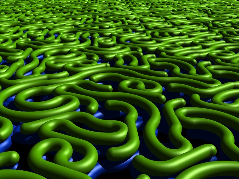

Here's a more advanced version of my previous maze. I changed the color
so that it wouldn't look so gross...
  Now, guess how is it done. Note that the pipes don't intersect anywhere.
Download 'Pipes.jpg' (136 KB)
With POV-Ray and a little help from it's math functions?

You used green tubes _on top of_ blue tubes.

  Forget the blue tubes. I was not speaking about them. They are just an
ornament so that the picture would not be so monotonic.

From: Chris Huff
Subject: Re: More organic looking pipe maze (138kbu)
Date: 2 Mar 2000 16:06:16
Message: <chrishuff_99-F84EC4.16065902032000@news.povray.org>
In article <38be75da@news.povray.org>, Nieminen Juha
An out of control delivery truck carrying a shipment of green and blue
food dye went on a rampage in a spaghetti factory?
That looks a lot like the sphere_sweep object from MegaPOV using a
non-linear spline...did you modify the maze macro to use sphere_sweeps
instead of torus/cylinder segments?
I notice that although none of the pipes cross, some do touch the
neighboring ones.
Sure looks to me like they do. They don't cross paths though...
Same way you made the other one but with different shape tiles?

Either a fractal, or random selection from a tilable set.

Chris Huff <chr### [at] yahoocom> wrote:
: That looks a lot like the sphere_sweep object from MegaPOV using a
: non-linear spline...did you modify the maze macro to use sphere_sweeps
: instead of torus/cylinder segments?
  Nope. It uses cylinders and torii (and spheres for the endings).

David Fontaine <dav### [at] faricynet> wrote:
: Same way you made the other one but with different shape tiles?
  You got it.
  I tried the same idea with a triangular tile and noticed how organic-looking
the pipes became. Looked cool to me.
  The source code, if anyone cares:
#declare R=.06;
#declare f60=sin(radians(60));
#declare Pipes=
  union
  { torus { .25,R } torus { .5,R }
    sphere { z*.75,R rotate y*30 }
    torus { .125,R translate z*.375 rotate y*-30 translate x }
    #declare d=.375*f60-.125;
    union
    { torus
      { d,R clipped_by { box { <-d-R, -R-.01, 0><0, R+.01, d+R> } }
        translate z*(.75-d)
      cylinder { <-d, 0, .75-d><-d, 0, .3>,R }
    union
    { torus { .125,R clipped_by { box { <-.25,-R-.01,-.25><.25,R+.01,0> } } }
      cylinder { x*.125, <.125,0,.2>, R }
      rotate y*-30 translate x*(.75-.125)
    clipped_by
    { intersection
      { box { <0,-R-.01,0><1,R+.01,1> }
        box { <0,-R-.01,0><1,R+.01,1> rotate y*30 }
        box { <0,-R-.01,0><-1,R+.01,1> rotate y*-30 translate x }
#declare t30=tan(radians(30));
#declare Rseed=seed(4);
#macro PlacePipes(place, angleOffset)
  object
  { Pipes
    translate <-.5,0,-.5*t30> rotate y*(int(rand(Rseed)*3)*120+angleOffset)
    translate place+z*(angleOffset?.5/cos(radians(30))-.5*t30:0)
#end
union
{ #declare indX=-2;
  #while(indX<12)
    #declare indZ=-2;
    #while(indZ<12)
      PlacePipes(<indX,0,indZ>, 0)
      PlacePipes(<indX+.5,0,indZ>, 180)
      PlacePipes(<indX,0,indZ+f60>, 180)
      PlacePipes(<indX+.5,0,indZ+f60>, 0)
      #declare indZ=indZ+f60*2;
    #end
    #declare indX=indX+1;
  #end
  pigment { rgb x/2+y } finish { specular .5 }
union
{ #declare indX=-2;
  #while(indX<12)
    #declare indZ=-2;
    #while(indZ<12)
      PlacePipes(<indX,-R*2,indZ>, 0)
      PlacePipes(<indX+.5,-R*2,indZ>, 180)
      PlacePipes(<indX,-R*2,indZ+f60>, 180)
      PlacePipes(<indX+.5,-R*2,indZ+f60>, 0)
    #end
  #end
  pigment { rgb z+y/4 } finish { specular .5 }
camera { location <-2,1.5,-3> look_at 0 angle 45 }
light_source { <20,25,-10> 1 }
main(i,_){for(_?--i,main(i+2,"FhhQHFIJD|FQTITFN]zRFHhhTBFHhhTBFysdB"[i]
):5;i&&_>1;printf("%s",_-70?_&1?"[]":" ":(_=0,"\n")),_/=2);} /*- Warp -*/
