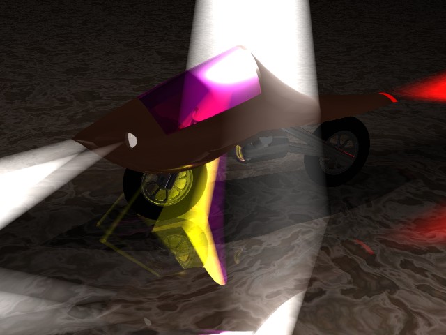

here is the picture again. Hopefully it is now uploaded ...
Hartmut
Comments ? ...
Download 'Mrad004.jpg' (55 KB)
Preview of image 'Mrad004.jpg'

That is one serious spotlight. I would alter the position of thelight
source on the headlights.... the light is coming out of a point on the
headlight instead ofthe entire surface of the light. Other than that,
good job!
Josh

Yes, i know the problem of the headlights, but did not want to wait another
2 or 3 hours. And i was realy happy that media has worked. I have rendered
some images (in lower resolution) that realy diapointed. The picture was
black, or it was totaly white. Spotlights with a falloff-value look very
disapointing, has anyone suggestions how to put a falloff-spotlight in media
without disapointing "pixels" at the border?
Hartmut
PS : For a person not talking english all the day, the names of the
media-parameters are hard to understand, and the documentation says not
enough. I will try to buy a dictionary to fully understand what every
parameter means ...

A good effort, but the second image I've seen today where the
media is too bright.  If we assume that the medial is at
colour rgb 1, truning it down to something like 0.7 or 0.6
I think would bring a big improvement to the image.
Keep up the good work.

What about the parameters of media that i have not used (confidence, rate,
variation)?
I have only used scattering mode 2 with mega-pov´s method 3 (renders faster
... (?)) and a jitter of 1.
Media seems to be a pov-function where trial (and long waiting) is the only
way to get results for new users of this command ...
Hartmut

I think a less sharp edge on the spotlight beams would be better.  The red tail
light looks okay but the white ones are very solid.  Might try to use a
'tightness 50' instead.
| variation)?
You have found it out  :-)
---insert---
Well, it's obvious I can't get povray syntax right when replying here instead of
using it in POV.  Sorry about my other reply here if anyone saw it.  Mistaken
stuff said.  I never use those keywords: confidence, variance, ratio (not
"rate". Well, I have used that one but it never seems to make a difference) in
media which is why i didn't think they belonged in a media statement.  Once a
newbie always a newbie ;-)
---insert---
I just realized the megapov.html file says there is a "new keyword --
sample_method" but then goes on to say only "method", so I suppose that is in
error.
Be careful if you ever use media method 2 instead of 3, the samples will need to
have the same minimum and maximum values to get a smooth media from what I've
seen of it.  Also the type 3 (you apparently used 2 though) for murky media
tends to thicken it up quite a bit.
But you're right, trial and error because every scene can be so different.
A lot of 'samples' perhaps?
| parameter means ...
I don't think confidence, variance, ratio really ever need to be used anyway
(unless you want messy results on purpose).  The other keywords are
understandable I would think.

S far as the headlights cut them off and pull them in so their shape is
restricted bu the cut around the lens...

I like the prism effect by the front wheel, caused by the purple wind
shield...
Very interesting...

	Method 3 isn't faster in and of itself, but it produces
better results. To get the same results with method 1, you
need to push the samples and confidence waaayyy high and the
variance waaayyy low... and then render time goes through
the roof.
	BTW:
* variance and confidence don't mean anything with method 3,
they only change something with method 1, and sometimes
method 2 (if min and max samples are different).
* ratio only changes something for spotlights, but you can
usually ignore it.
		Jerome

Thanks, that saves lot of compution time ... And of course most of the
parameters can be understood. Anything about falloff-spotlights? It took
long for me to see that the falloff was disturbing the light-cones. Perhaps

It could be that the 'samples' and/or 'intervals' need to be increased.  When
the intensity is lower the granularity might be showing up more and that's what
you are seeing then.  If the media is smooth everywhere but certain places, like
shadow edges, then almost certainly it's those parameters which need to be
raised.  It doesn't have anything to do with the lights themselves, except the
more you have then the more sorting out that has to be done, but that's nothing
to do with 'falloff' values.
All I knew before was that 'ratio' in the media is meant to make changes to the
light edges, if it does indeed affect the falling off of light too then I never
knew that before.  And if so it might need to be set lower (default is 0.9).  It
does say in the help that it's lit to unlit ratio.  I just got it into my mind
that meant edge of the light cone (or cylinder).
"Hartmut Wagener" <har### [at] arcormailde> wrote in message
news:38bd98f1$1@news.povray.org...
| triying a little bit with tightness will bring an answer ...
| Hartmut
| Bob Hughes schrieb in Nachricht <38bc6f4d@news.povray.org>...
| anyway
| >Bob
Subject: Re: RE : My first picture with media (Hopefully it is now uploaded ...)
Date: 1 Mar 2000 17:56:45
Message: <38bda02d@news.povray.org>
I should point out that I keep reading your "fall-off" to be the keyword
'falloff' in the 'light_source'.  You of course might also be talking about the
edges of the spotlight cones.  Same thing anyway, 'ratio' is intended to change
how the lit and unlit media is sampled.  As the help file states, it is biased
toward lit media so I'm guessing lower than 0.9 will move toward a unlit bias.
And if a ratio of 0 to 1 is the intended range then 0.5 should be an equality.

Thanks,
i hope that helps me understanding media and spotlights (i use spotlights
very rarely).
I think i will test a little bit media without my converted models, perhaps
the rendering is faster then ...
Hartmut
