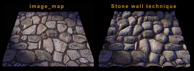

Here you see the "before" and "after" images.
Find out more at http://www.kivisalo.net.
K.K.

Very nice !
 Will you be leaving your "tutorial" at that address ? If you do then I
will link to it from the POV-Ray tutorials section of povray.org links
pages so that others may learn from it as well.

wow. I like. now how to do that with real-time 3D...

Absolutely elegant method -- simple *and* effective.  Thanks very much for
sharing it.
Best,
Claire

Ooh! Aah! Where does the original stone map come from?
