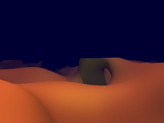

I've made a smooth landscape using an isosurface containing noise3d + y
.  Note in the image below how some of the features are truncated: flat
tops. I want it to be completely smooth, but have this general feel.   I
was trying to figure out what might have been wrong with my code.  But
then I remembered a similar thread about some of the noise-based
pigments in povray.  Did I hear something to the effect that the pov
designers used an unorthodox definition of the noise (something about
the interval?) ?
The question is: which of the scenarios below are most probable:
1. I may acheive smoothness by fixing my code;
2. I will fail because these flat tops are inherent in any (correct)
application of noise;
3. I will fail until a pov version comes out with a "correct"
application of noise.
Download 'isosu368.jpg' (5 KB)
Preview of image 'isosu368.jpg'
From: Ron Parker
Subject: Re: Ignorant question re: noise (5kbbu)
Date: 7 Jan 2000 08:39:17
Message: <3875ec85@news.povray.org>
My guess is 1.  I don't think noise3d suffers from the same problems
as bozo and other patterns.  Try making your bounding box larger.
These are my opinions.  I do NOT speak for the POV-Team.
The superpatch: http://www2.fwi.com/~parkerr/superpatch/
My other stuff: http://www2.fwi.com/~parkerr/traces.html

Thanks for the speedy reply.
No, I believe I have a bounding SPHERE, but I'll have to check the code
at home this evening.
I acheived this surface by something on the order of:
    isosurface{noise3d(x,y,z)  + y }.
___________________________

From: Chris Huff
Date: 7 Jan 2000 08:55:28
Message: <chrishuff_99-025418.08553807012000@news.povray.org>
Actually, it does, but it doesn't show up in most images because the
flat area is in the center of the blobs formed. This simple isosurface
demonstrates the problem:
isosurface {
   function {y - noise3d(x*2, 0, z*2)*0.33}
   eval
   max_gradient 1.1
   threshold 0
   bounded_by {box {<-2,-2,-2>, < 2, 2, 2>}}
   accuracy 0.001
   texture {
      pigment {color rgb < 0.095, 0.45, 0.2>}
Chris Huff
e-mail: chr### [at] yahoocom
From: Mike Wilson
Date: 7 Jan 2000 09:42:17
Message: <3875FB3E.46031B75@iastate.edu>
I may be compeletely wrong, because I don't have a lot of experience
with isosurfaces, but I did run into something similar.  It seems to me
that the isosurface code works "backwards" from normal POV-Ray
nomenclature. i.e. something like isosurface{y-noise3d(x,y,z)} actually
adds the height of the noise to the plane whereas
isosurface{y+noise3d(x,y,z)} subtracts the noise from the surface.
Likewise it seems that increasing the x,y,and z values makes for smaller
noise features. e.g. noise3d(x*20,y*20,z*20) makes finer detail than
noise3d(x*3,y*3,z*3).
You may simply be running into your bounding box.  Try translating the y
component of your isosurface down a bit at see it the tops of your noise
"finish out".
Mike Wilson

From: Chris Huff
Date: 7 Jan 2000 10:04:49
Message: <chrishuff_99-077D84.10045907012000@news.povray.org>
That isn't backwards at all. The isosurface of the function y-1 will
consist of all points where y-1 is the threshold value. Increasing the
amount subtracted from the y coordinate means y has to be higher to
result in the same value. When noise3d equals 1, y has to equal 1. When
it is added instead, y has to equal -1 to get the same result.
Again, this is not backwards. If you multiply x by 2, than the result of
that expression(2*x) will be a certain value at half the distance it
would be without the multiplication. The result is compressing the
coordinates into a smaller space, scaling down.
If x is 3, 2*x will be 6, and the features that would have been at x=6
will be at x=3 when 2*x is used.
Chris Huff

From: Mike Wilson
Date: 7 Jan 2000 10:30:17
Message: <3876067B.A9E916EE@iastate.edu>
You're right. of course.  I wasn't implying that it was wrong, just that
it "appears" backwards compared to other types of scaling.  For example,
if I wanted a large bump scale on a normal, I would increase it, but
with noise3d, I would use a smaller number.
As, I mentioned, I don't have a lot of experience with isosurfaces, so I
don't think in terms of how the function will be satisfied; I'm relating
it to similar POV-Ray statements.
Mike Wilson

Say F() is a function that takes one parameter and returns a unique
value for every value given it.
If A=F(x) when x=6, A=F(2*x) when x=3.
If the function gives a certain result for a certain input, multiplying
the input numbers by 2 will make it hit that result twice as soon.

It's been my experience that noise3d does suffer from flat crests and
troughs (to use an analogy). I've not encountered any way to avoid it,
either. I wish there were a way around it, though.
