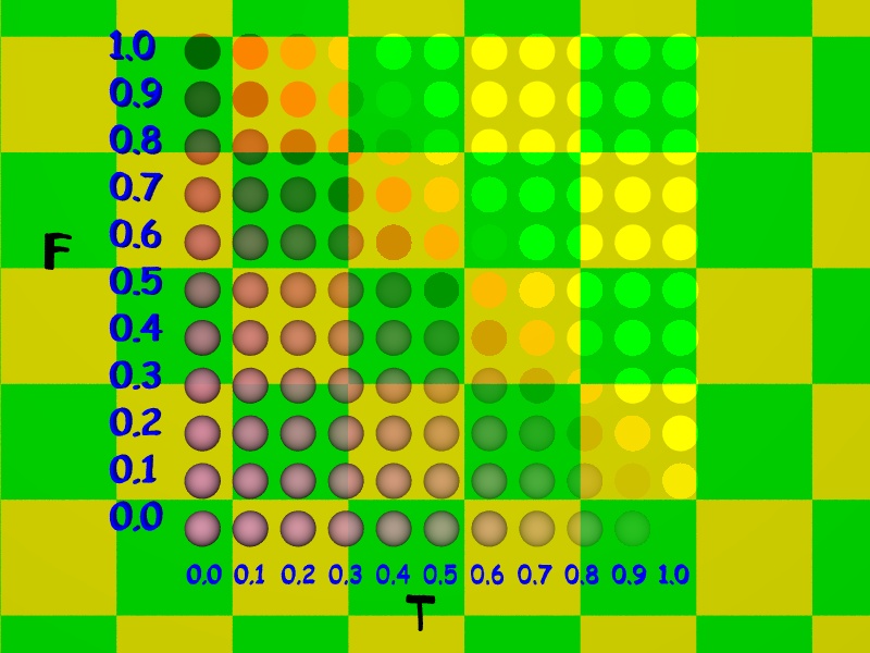

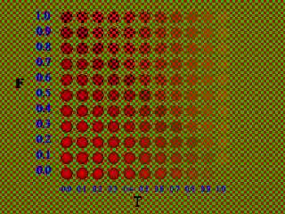

I was trial-and-erroring the other day with filter and transmit values
in rgbft, so I made this little chart to get an idea of what was going
on. Hope it helps.
Andy

This is great! But perhaps it would look better if the floor was less brightly
coloured. Try a darker yellow and green, or perhaps a single colour I don't
really know the result. Also perhaps you should change the lighting angle, it
is hard to tell which is the sphere and which is the shadow in the more
translucent objects.

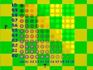

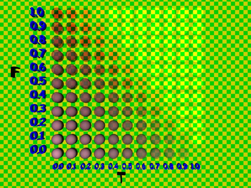

 Here is a revised version, with no shadows and a larger size on the
checker. I left the checker in so that the effect of the transmit variable
would be more discernable than with a single color background.
Andy

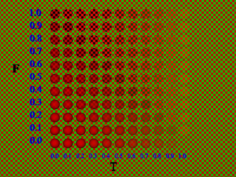

One more. Sorry about the filesize but tighter jpeg compression really
gummed the image up. This time the background is pure green and pure red, with
pure red spheres (e.g., pure red=rgb<1,0,0>). This helps to show the effect,
note where f=1.0 and t=0.0, the green checks are black since no green is
transmitted, but the red checks are indistinguishable from the rest of those in
the plane.
    Also of interest is the top right corner, where both values = 1.0; the red
value is intensified since the transmission imparted by each value adds.
    I apologize for the pattern's harshness to the eye, but it's more for
instruction than aesthetics. Also, the source is posted in p.t.s-f if anyone is
interested.

Rikard Bosnjakovic wrote:
> When posting HUGE pictures like that, it's wise to type the imagesize in
> the header or such. I don't care, because I'm on an ethernetconnection
> at no cost at all, but there are modemusers (*g*) out there.
That struck me seconds after I posted it, sorry to anybody whose works got gummed
up.
