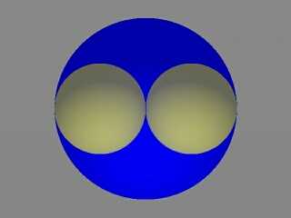

Will someone please tell me why the following code renders as it does?
(place a camera at <0,0,-12>)
sphere{<0,0,0>,5 pigment{rgbf<0,0,1,.5>}}
sphere{<0,0,0>,2.5 translate -2.5*x pigment{rgbt<1,1,0,.5>}}
sphere{<0,0,0>,2.5 translate 2.5*x pigment{rgbt<1,1,0,.5>}}
gives me the image attached.  now; is it me, or, shouldn't the edges of the
small spheres meet perfectly with the edge of the big sphere?  I say this is
a stupidity problem simply because, well, it's obviously something simple
i'm not getting.
Mike Metheny
lon### [at] vtedu
mik### [at] loneshepherdcom
http://www.loneshepherd.com/
"When one's words are no better than silence, one should keep silent."
Download 'problem.jpg' (13 KB)
Preview of image 'problem.jpg'

<< You are correct in assuming the misconception on your part was the key
 player in this little drama. A sphere represented as:
 sphere { <0,0,0>, 1 = a sphere "2" units across !!!
Yes I understand this Ken.  But is not a sphere, sphere{<0,0,0>,5} centered
by default at the origin?  So, it extends, 5 units up, 5 down, 5 left, 5
right, 5 in, 5 out.  it is completely centered.  Thus; by making a sphere
radius 2.5 (diameter 5) by translating it by it's radius to the right, the
left edge should be at the origin, and the right edge should be at 5,0,0
correct?  In this image it does not appear that way.
Mike Metheny

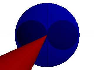

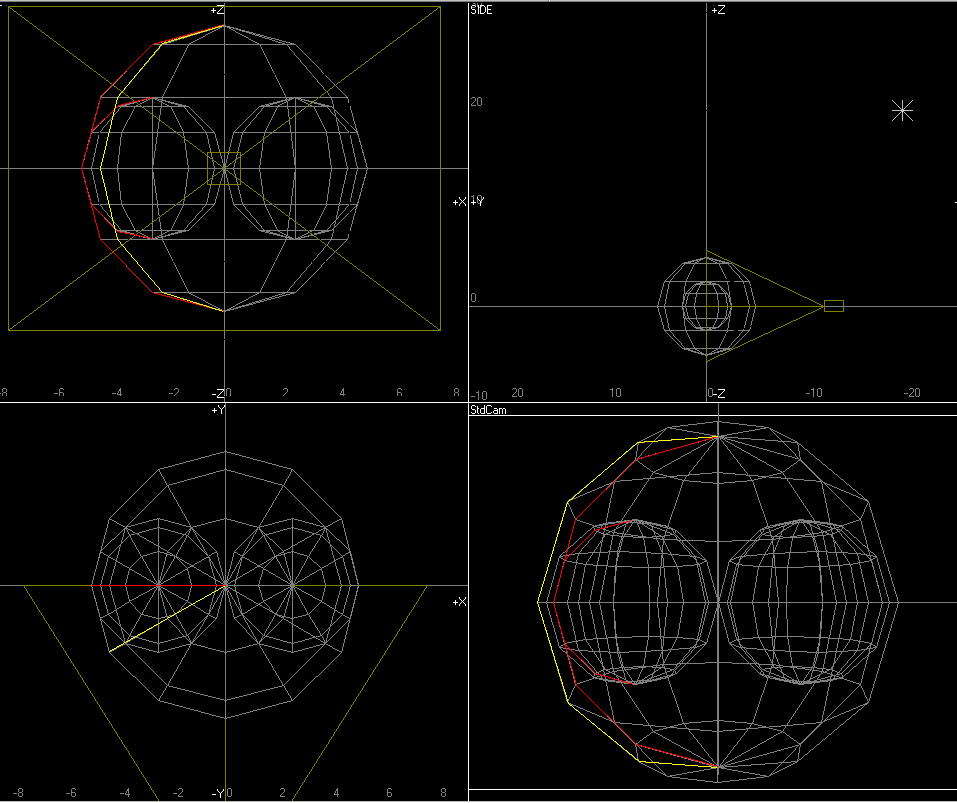

From: Johannes Hubert
Subject: Re: Stupidity problem
Date: 21 Apr 1999 03:47:17
Message: <371d7475.0@news.povray.org>
Sorry Ken, but you got your maths wrong here.
The spheres are scaled and translated correctly to give the expected result.
Actually, they *do* give the correct and expected result!
I agree with GrimDude: It is a problem of perspective.
The camera is so close to the outer sphere, that the near part is
perspectively magnified so much, that it appears larger than the X/Y-plane
"equator" which lies farther back (and where the sphere really *do* meet at
the edges as expected.
I attached a screenshot from Moray where I recreated the scene and then
marked the actual equator with red and the *percieved* outer edge with
yellow (front, side, top and perspective view).
So long,
Johannes.
Download 'spheres.gif' (28 KB)
Preview of image 'spheres.gif'

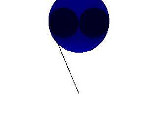

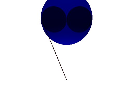

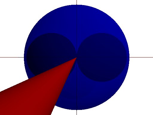

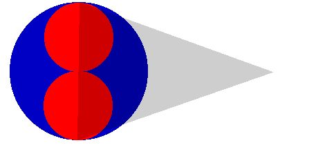

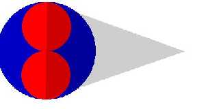

From: GrimDude
Subject: Re: Stupidity problem -9kb attachment
Date: 21 Apr 1999 16:06:30
Message: <371e21b6.0@news.povray.org>
TIC, Andy. :) The author implied it was the coding that was in error. No big
deal.
I continue to get email on this, so here's an overhead view with a cylinder
marking a straight line from the original camera point to the point in
question.
camera { location <0,20,-6> direction z look_at <0,0,-6> }
light_source { <0,0,-12> color rgb 1 shadowless }
background { color rgb 1 }
cylinder { <0,0,-12>,<-5,0,0>,.05 texture { pigment { color rgb
<1,0,0> } } }
Download 'Perspective.jpg' (9 KB)
Preview of image 'Perspective.jpg'
> So long,
> Johannes.

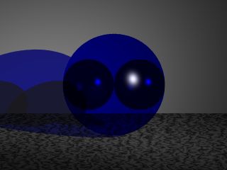

Yep, it is a matter of perspective and visual abberation. A picture is worth a
thousand words:    <your spheres sliced in half>
Download 'amigos.jpg' (12 KB)
Preview of image 'amigos.jpg'

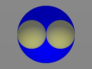

Try moving the camera Waaaay back, and setting the angle down to 5 or so.
<p>camera{location<0,50,-250> look_at<0,0,0> angle 5}
<p>Here is an example of what I did, and what you did wrong.
<br>
