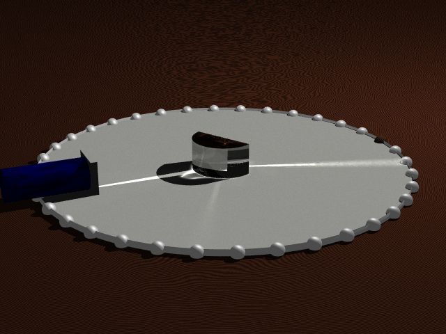

I've rendered a better version for my lab report. Just thought it
*might* slightly interest someone out there.
I just want to point out that in my experiment, twisting the half-circle
lens 30 degrees would cause the light beam to bend 20 degrees. So I
tried it in the scene and it worked. The dark sphere is 0 degrees, and
every other sphere is 10 degrees more off.
Download 'physqqp.jpg' (41 KB)
Preview of image 'physqqp.jpg'

The light beam doesn t only "bend" of 20 degrees
but is also slightly reflected at 120 degrees ;)
-=Nicolas=-

It's NOT a laser. The  cylinder on the left is a flash light, with a
piece of plastic blocking it. There is a thin, long, hole in the plastic
which allows a thin beam of *regular* light to go out.

But such a beam would break up into different colours after leaving the
prism. The standard POV can't simulate that. By using a monochromatic
light source such as a laser this wouldn't happen (and the output of POV
would be correct! :-) ).

I handed in the lab report today, but I would like to know how to
specify a spectrum for the light source (in UVPOV)

I guess not in UVPOV. Have a look at:
http://www.newcolor.com/darenw/dswpov/dswpov.html
Marc

Here is a quote from a recent post by Nathan Kopp:
> I have implemented dispersion, but there's no default spectrum.  If you
> creat your light source like this:
> light_source
>   <10,10,10>
>   color <1,1,1> // this will be replaced, but the parser is a hack right
>                 //   now, so it is still required
>   color_map{    // here you define your light's spectrum
>                 //   this color_map acts like "average":  the first value is
>                 //   weight (intensity), the second is color
>     [1, <.5,0,0>]
>     [1, <.2,.2,0>]
>     [1, <.3,.3,0>]
>     [1, <0,.5,.5>]
>     [1, <0,0,.5>]
> Notice, the color map entries added up to <1,1,1>.  This spectrum will
> probably look bad (I made it up just now), but you get the idea.
Jerry Anning

Does this mean that UVPov can't actually simulate colour splitting. Instead you
have to fake it by defining the spectrum colours?
Subject: Re: Povray phyics simulation
Date: 16 Apr 1999 01:25:22
Message: <3716BB94.6C499AB@aol.com>
Unfortunately, yes, I believe so. Same went for dispersion before it got
hard-coded into that custom compile of POV-Ray. You did the dispersion
about the same before then, by using texture averaging of the
refractions. Then POV-Ray code changed and it didn't work with 3.1
anymore until the dispersion patch.
Thomas Lake wrote:
