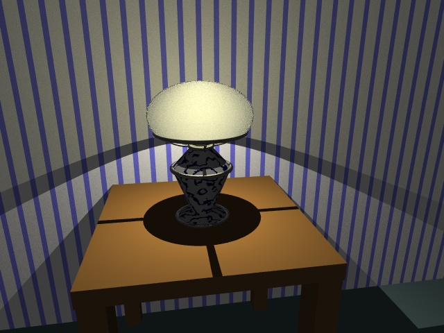

Here's a little scene to demonstrate using media to simulate translucency
(diffuse transmission). Dont' tell me the wallpaper, table etc. suck. I know
and right now I don't care. Just concentrate your gaze upon the lamp shade
and tell me what you think.
I had to use very dense media to get only diffuse light transmission (rgb
1500). This posed a bit of a problem, understandable when you read my post
about media_interaction (in .general). So there are actually 2 lamp shades:
one, the media container, with a clear filter and no_shadow to avoid the
shadow of the media (which would be nearly opaque in this scene); and
another, slightly thicker, using a yellowish filter to create the shadow you
see.
In the process, I encountered other quirks. Using a area light changes the
appearance of the media radically (much brighter and horribly grainy). Using
transmit also makes the media very grainy. I'm still exploring these
problems.

The table mearly sucks. The wall paper sucks immaculate. I will let it go
since it is a proof of concept image.
> see.
> problems.
> Margus
Hi Margus,
  I think you are on the right track if media is the choice you
prefer to model translucency with. I still think there are other
alternatives but I am not going to say what until I get a chance
to test my own theories. Your rgb values sound a bit whacko and
I don't understand why you would have to go so high with them.
In this business whatever works I suppose.
Ken's tip of the week:
   An interesting thing happens to media used inside a container if you
add an ior value to the interior statement that also contains the density
statement. I don't understand exactly what happens but it has a tendency
to polarize(?) the grain structure of the media providing a somewhat
smoother appearance. It might be worth trying with the media in this model
to see how different it is and if it behaves better or worse. I tried this
with a color list patterns study I did about a month ago and there was a
noticeable difference in how the density appeared. In the case of where I
used it the difference was better as it both smoothed the density of the
media as well as giving it better visibility in the lighting conditions
that were used.
  Your mileage may differ and some restrictions do apply. See your local
representative for details or answers to other questions you may have
concerning these restrictions and ways you may remedy them. Void where
prohibited or restricted by law. All rights reserved. No other conditions
apply whether implied or otherwise.
 Have a nice day :)
Ken Tyler

Ken wrote in message <37112AB4.43CC4E3C@pacbell.net>...
>Hi Margus,
I am appropriately intriqued, yet I respect your reserve and aspire to
contain my curiosity. Quite frankly, I can't imagine what alternatives you
have in mind (except bezier patches)
The scale of this scene is rather small and the walls of the shade are <0.01
units thick. So this value is by no means whacko. Anything less makes the
shade transparent (non-diffusively).
As for your tip: you are indeed correct. Adding ior to the media container
makes it much smoother. I already had ior in the outer (yellow) shade, but
this had no effect... Unfortunately, this also greatly changes the lighting
of the media, to something that is, in my opinion, incorrect. More
specifically, the top of the shade becomes extremely bright - possibly
because the light_source is closest to that part.
Yet another media mystery. I would VERY much like to know the explanation.
I will contact my solicitor for a detailed analysis of this statement and
any obligations, financial or otherwise, it may impose upon my person.
> Have a nice day :)
And a good night to you, kind sir!
Margus

While this is OK, I imagine that the rendering time is quite large... what I
was proposing is for someone to write a specific function for it... not only
would this be faster and easier to work with, it would also have no sampling
problems commonly associated with media...
Anyway, I think you're on the right track though and that's looking quite
good!
Now see if you can do this, a lit candle... :)
Lance.

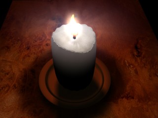

> Lance.
Been there done that long ago. Piece of cake. See below.
Ken Tyler
mailto://tylereng@pacbell.net
Download 'kcandle.jpg' (3 KB)
Preview of image 'kcandle.jpg'
From: Lance Birch
Subject: Re: Translucency demonstration (97 K)
Date: 12 Apr 1999 00:05:46
Message: <3711630a.0@news.povray.org>
he he, that wasn't exactly what I mean by the candle... But it's nice
candle!!!  :)))  I just meant, with translucency... :)  But I'm sure you
already knew that :)

  I don't know. Can you find anything uncandle like about the
appeareance of the candle image I posted. I thought not. Ok so
maybe a closer examiniation would reveal the lack of the material
properties you describe, then again it might not. I think I will
keep you guessing for the time being.
Ken Tyler
From: Lance Birch
Date: 12 Apr 1999 00:15:38
Message: <3711655a.0@news.povray.org>
Well, the main thing I was looking at was the light fading in the candle...
(downwards)
You know how when you light a candle the top part is a lot lighter than the
base (and I don't mean the flame there either ;-) he he he
Also, the top part of the candle should be shinnier than the bottom (because
the wax is heated and takes on a shiny appearance).
Just a thought...
Lance.

From: Peter Popov
Subject: Re: Translucency demonstration (97 K) - CANDLE.jpg
Date: 12 Apr 1999 03:13:14
Message: <37118e4f.1961160@news.povray.org>
On Mon, 12 Apr 1999 13:14:37 +1000, "Lance Birch"
>(downwards)
>Just a thought...
Do you like this implementation, Lance? This is part of my May-June
1997 entry, re-rendered in 3.1 (no halo). Check the IRTC archive, I've
posted source too (indented and commented :) ). HTH.
Peter Popov
ICQ: 15002700
Download 'CANDLE.jpg' (21 KB)
Preview of image 'CANDLE.jpg'
From: Ken
Date: 12 Apr 1999 03:38:20
Message: <37119290.3B46385D@pacbell.net>
> >(downwards)
> >Just a thought...
> Peter Popov
Hi Peter,
  I like it.
  I just visited about 20 candle web sites trying to get a good image
of a real burning candle and dicovered one surprising fact. People who
manufacture and sell candles know absolutely nothing about photography.
In virtualy all cases the candles were brand new when the photos were
taken and the flames were dancing at the ends of their long new wicks.
Added to this the majority were photographed against a light background
that reflected the over enthusiastic use of flash photographay which
nearly washed out the brilliance of the candle flame itself.
  One thing that I did notice is that a lot of what I think we percieve
as translucence is as much a pigmentation characteristic coupled with
a soft but very uniform reflective surface. The reflection on the
surface of a smooth candle is pretty high. I would guess a reflection
of .2 - .4 would be close to real.
  Also I just lit a candle that is designed to burn down through the
middle and leave the shell intact. Is has a splotchy red, dark turquoise,
and light pink pattern that goes through the candle. When looking at it
in a darkened room there is not nearly the kind of glow that you would
imagine. If aything it looks more like a pigment that has the ambient
setting turned up about .3 too high. Perhaps this varies from candle
to candle but I have no doubt that I could render an accurate duplicate
of this candle without the need to resort to anything else but standard
pigments and finish statements.
Ken Tyler

well the candle itself is lame but the flame is incredible.  can you
share that code please?
<still banging his head about media>
From: Ken
Date: 12 Apr 1999 06:31:47
Message: <3711BB1A.8E67434D@pacbell.net>
Well lame this buddy !
Oh excuse me I got carried away.
  It is available at the Pov objects collection at http://twysted.net
the file is titled candle2.pov(zip ?) I don't remember the file extention
listed at the site. It is the number three downloaded object for the whole
collection so I think it is a popular item type. Either that or there
are a large number of confused pov users out there that are snatching
up anything that has media source so they can learn from it.
Ken Tyler

From: Margus Ramst
Date: 12 Apr 1999 08:28:00
Message: <3711d8c0.0@news.povray.org>
The render time was about 15 minutes, at AA 0.1
This image made me wish for the good ole' days of the halo, which was faster
and less noisy. But both halos and the method you describe have one
shortcoming - inflexibility. With media, I can apply a density pattern and
achieve VERY interesting results.
For my next trick, I may indeed produce a candle.
Margus

From: Margus Ramst
Date: 12 Apr 1999 08:28:21
Message: <3711d8d5.0@news.povray.org>
I also lit a candle to see what it looks like. Mine, however, had a white,
(presumably) more translucent inside. I indeed observed a glow in the
candle, going even deeper than I expected. Almost like an ambient gradient,
but not quite. No reflectiveness was observed, but then, the room was nearly
pitch dark.
Oh, and Peter, your candle sure looks good!
Margus
Ken wrote in message <37119290.3B46385D@pacbell.net>...
>Hi Peter,
>  I like it.
>Ken Tyler

>the light fading right... but anyway, here it is.  The candle is a
>traditional dipped candle, so it obviously doesn't look like the previous
>posting from you (which looks more synthetic, or at least a "mass-produced"
>style).
>I've focused more on trying to get the translucency right than the model,
so
>please don't criticise it TOO much!  :)
>I've also tried to simulate the bulging which is typical of these kinds of
>candles... (the natural wax is not as, um, what's the word, durable(?) as
>synthetic wax).
>I've also tried to introduce some blotchiness into the wax... it doesn't
>show up much on the sides at the moment, so I'll have to work on that...
>I'm going to post an example of the "rice paper" shadow casting soon
also...
>I've made a kind of resin texture...
>Anyway, enough talking!!!  Tell me what you think!  :-)
>Lance.
>P.S.
>> do everything better software, made for the "real artist", 3d modelling
>Did I say it did everything better?  NO!  In fact I criticised it's
>raytracer for being slow...  As for "real artist" I never said that
>either... in fact I believe that renders are just artists' tools.
From: Margus Ramst
Subject: Re: Translucency demonstration (13 K) <--- For Ken :)
Date: 13 Apr 1999 14:07:28
Message: <371379d0.0@news.povray.org>
Yeah, I'd say that is what a lit candle should look like. The flame is too
bright, but I guess that's not the point here.
Still, I'm beginning to wonder if it would be possible to make a transluce
with nothing but an ambience gradient...
Margus
Lance Birch wrote in message <3712e32d.0@news.povray.org>...
>OK, I've made a candle as you requested in MAX, I must admit it needs a lot
>of work to get it looking right, I've never used the translucency blurring
>in MAX before, so I think the settings need changing a bit before I can get
>style).
so
>synthetic wax).
also...
>Lance.
>P.S.

Message: <37144e3c.0@news.povray.org>
I was just about to point that out :)
Yes, it should be possible to do that... of course if you're using multiple
light sources it could become tricky, but for a candle using an ambient
gradient should work just fine I think...
Lance.

From: Lance Birch
Date: 14 Apr 1999 05:15:15
Message: <37144e93.0@news.povray.org>
You didn't really tell me what you thought Ken... :-(
Oh well... yes, I agree with Margus.  The flame is way too bright... (looks
more like the beginning of a small nuclear explosion actually ;-)
For a candle an ambient gradient should suffice...
Lance.
