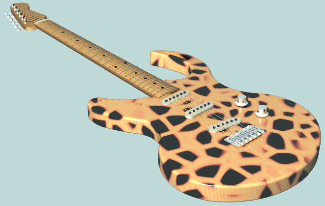

Here's an updated version of my electric guitar model.
The neck is thinner (thus, easier to play), but the junction
between the neck and the head is still not very good (it's hardly
CSG-able).  The bridge (no tremolo) is much more detailed,
and now placed at the right distance (distance between nutshell
and 12th fret is equal to distance between 12th fret and bridge).
Knots are a little more ineresting too.  The body received some kind
of feline 2-tones sunburst finish.
For those who asked how I made the chamfered body, I used 2 macros
that makes "beveled" pie-parts and negative pie-parts (bended towards
the outside, I can't explain better (no, really, I can't ;)).

From: Bugs74
Subject: Re: Updated electric guitar
Date: 11 Apr 1999 14:21:48
Message: <3710da2c.0@news.povray.org>
Well, the bridge and the knobs look a lot more realistic. Good Job...
The only thing I'm still missing is the tremolo-bar... (Especially withn
such a bridge...)
Bugs74
From: bankspad
Date: 11 Apr 1999 14:26:12
Message: <3710D6F5.32B2970F@pacbell.net>
Wow! The grain on the body is beautiful, and I like that finish pattern. My
2*¢ - the volume and tone knobs need to be angled outward a tad and further
from the pick-ups, maybe toggle switches to select between pick-ups, and
perhaps a pick-guard to protect that incredible finish.   ;-]
KB-

From: Dylan Beattie
Date: 11 Apr 1999 19:20:31
Message: <37111F27.A78170BB@ecs.soton.ac.uk>
> such a bridge...)
Nah, it's obviously been removed - greater tuning stability, hence less
time adjusting the tuning, hence it renders quicker...
...or something. :)
Date: 12 Apr 1999 03:29:49
Message: <371192B3.257BC751@aol.com>
I like it a lot.
You need to try a larger depth (+R) for the antialiasing to get those
strings to turn out better though. Speaking of strings... did you
texture (or model) them with the ridges (forgive me, I'm music
illiterate) in the lower note strings.

From: Ken
Date: 12 Apr 1999 03:48:52
Message: <37119504.665761C6@pacbell.net>
Bob Hughes wrote:
> I like it a lot.
Why neither method was used. This is so realistic looking, that he was
able to go down to the music store and buy strings for it, then came
back and reached into the screen and installed them in place. Reality
in a virtual sense.
Date: 12 Apr 1999 11:39:45
Message: <371203E6.8DB088DF@ndirect.co.uk>
This is looking really good.
One thing that is still missing is something for the strap to
hook onto.
Steve

From: Mikael Carneholm
Date: 12 Apr 1999 14:03:22
Message: <371226A9.94A6E898@ida.utb.hb.se>
I would never play this guitar, for three reasons:
- It's a 21 fret neck. (I hate to bend a minor 3:rd to reach that high E
when soloing over a E minor progression)
- The cut-away is made on the wrong side for a right-handed player (i.e,
me.). Makes it even harder to reach that high E.
- No humbuckers. I can live with single-coil, but only if they are Seymor
Duncan pickups (or EMG) with high output. Just to let you know.
-  Mikael (equally lousy guitar player and programmer)

21 frets, like my Strat 57 reissue; there's much fine music to play
between fret 1 and 21, you know...
(and about that E, just use harmonics...)
Makes it easier to reach the lower strings with the thumb.  Anyway,
there is fine music to play between frets 1 and 17...
Ever heard about _stacked_ humbuckers ?  They looks (and mount)
the same as single coils, and avoid the _ugly_ appearance of
these big humbuckers...

I really your guitar, especially how you were able to get that nice beveled
edge! Now I know nothing about electric guitars so if what I am saying sounds
completely insane just ignore it, but isn't an "electric" guitar supposed to
have an output jack somewhere on it to hook it up to an amplifier?

I think that the output point on this model would probably be on
the edge of the guitar on the side that ce can't see.

I am sorry, I just wanted to surprise people by showing that I know something about
electric guitars (and also indicate that I <used to> play some before realised that
I was too mathematically minded too actually _make_music_ ).
It's a great image, and I even thought I could help by indicating that the body
should be rotated 180 degrees to be playable for a right-handed player (since the
neck is a right-handed neck).
Once again: good modelling/texturing!
