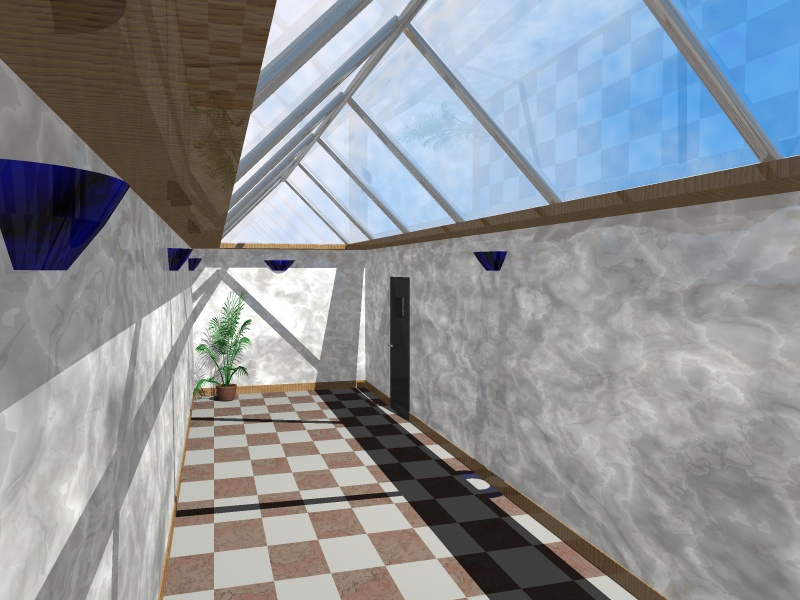

As the title indicates, here it is.  This is a scene I'm working on for
a computer game.  It's not finished yet, obviously.  It's actually a
hallway in a hospital in the future.  Like the plant?  I'm not sure what
to do for the wall texture.  By the way, would this image benefit in any
way from Nathan's photon patch?  Just curious.  DOH!! I just noticed
this, it looks like that ledge on the right side wasn't quite up against
the wall, There's a bunch of light streaming in behind it!  man that
stinks...
Any suggestions?
		Kyle

  I doubt it would benifit from the use of photons. The use of radiosity
on the other hand is suggested. Photons are better reserved for situations
where there is likely to be refracted light passing through a substance.
Flat panel glass has little if any refraction value. Flat panel glass with
water sandwiched inside like an aquarium would be a better example when to
use it as would prisms, drinking glasses, and hand blown glass works.
 Nice plant.

Yeah, I didn't think it would really.  I had tried a rendering w/
radiosity but strangely, didn't see a difference really.  Maybe I'll try
that again.  You like the plant!  You really like the plant!  I knew it
was a winner :-)  Thanks for the comments Mr. Tyler.
		Kyle

I'm going to make some suggestions to my own pic.  I think it needs some
more *plants* :-)  I think I'll try to put some ivy looking stuff up on
top of those ledges.  Yeah, that's the ticket.  And um... then I'll try
to render it w/ radiosity, and I'll fix that ledge on the right.  Then,
after that, I'll make those white tiles a little bit whiter.  Then, I'll
put in a nice food cart w/ some green jello and rubbery salisbury steak
on a plate.  Anything I'm missing?

Did you mean for the wood beam on the left to be reflecting the floor
and
cool plant? It looks as though the beam is supposed to be roughly cut
which
of course wouldn't reflect much if anything.Unless it's shellacked; I
had a bar
in the basement of the last house I lived in. The boards were cut very
roughly
and then about an 1/2inch(no kidding...I didn't build it)of shellac was
applied
over the top to make it smooth...
Mr Clooney ?
BTW I think that the ledge on the left, is made of wood, isn't it, so made
be it should be less reflective (hard to polish every day !)
Philippe

I have a couple of suggestions:
For the walls, perhaps scaling the "marbeling" down to be just a smidge
tighter, and then breaking up the walls with panel marks, then rotating the
texture just a hair on every few panels. Since the scene is based in the
future, perhaps some monitoring epuipment embedded in the walls, sliding
panels, comp. interface, holograph x-ray view screen. I really like the plant.
Maybe instead of being "potted" it could be set up for hydroponics, set into
an inset in the wall with grow lighting and an environment control panel
and ... and ... and ...
Well, if nothing else, your image definetly encourages the imagination.   ;-]
 Thanks for the suggestion for the wall, I think that'll look MUCH
better.
Ahh yes, computer screens, can never have too many of those :-)
I knew you would like the plant, everyone likes the plant.
> I hope I didn't overspeak myself.
Not at all. I like criticism.
	Kyle

Oh, you like the plant?  Well, it was just a little something I threw
together...:-)
I did mean for the beam to be reflective, no good?  Is wood highly
polished in the future?  I'm not sure.
Maybe I'll tone it down just a bit.  Thanks for the suggestions :-)
		Kyle

Make sure your objects have an ambient component and that you set the
global ambient (ambient_light) value higher than normal.  The 'radiosity'
stuff takes the place of the ambient component, and if you have no
ambient, you have no radiosity.
-Nathan

Hmm...yes, perhaps I will share the wealth.  It's a Moray UDO file that
I will post in the moray.binaries newsgroup right now.  I can post the
actual POV code if you would like, (though it's 900KB) so I don't know
if it's worth THAT much to you.  I'll go post the Moray file now.
		Kyle

Only one door eh? Must be a specialists hospital :)
I don't think photons would apply well here, unless those indirect
lights were semi-transparent when lit. Wall texture seems fine to me.
Not so sure about the "ledges" though. Wood-grain running perpendicular
to the length? To each his own, heh-heh. Looks like you also need to
match up those ceiling beams to the apex.

Nice. Well, It misses something, a feel to it. small curtains??
And, some more plants, yes :-)
whoo, more...A bit more filtering lamps... perhaps move them away from the
wall(some metal hanging on theem)
overall a good image.
hmm, make a plant macro soon ?

The more I look at this and think about it I'd decide to make it a
contemporary image (the future isn't all it's cracked up to be, or
hasn't been so far).  Something like an old dusty looking clock on the
far wall with Roman numerals on it, don't know if the blue cones on the
walls are meant to be lights or not, but I'd put some small hanging
plants in them.  Yes definitely another door or two.  A broom in the
corner.  Don't think I've ever seen a floor reflected in a sky light
like this before, but ther's a first time for everything.
Really nice plant by the way,  it should be a bit closer to the camera
so that we can see it a bit better.
The door seems to be a bit lost here, can't really see any features in
it, I'm sure you didn't just create a plane door.
Great image.
