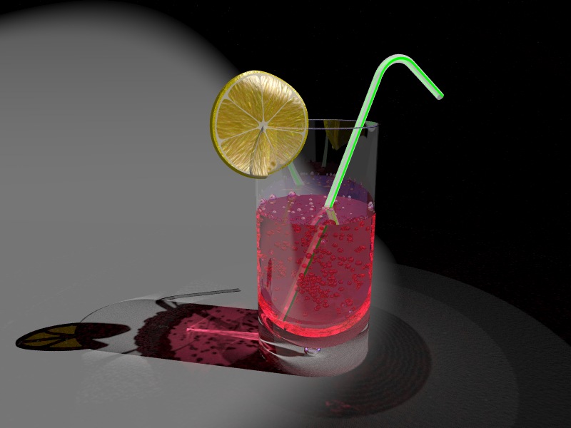

I'm not quite happy with the lemon, any suggestions?

Ah, refreshing. And refreshing picture too!
See you even added a air bubble in the base of the glass.
The lemon slice is good, think it's just the fact it's such a perfect
looking slice is all.
You could have used a turned up liquid edge inside the glass there,
appears kind of flat. The gas bubbles are really neat, though having
them diferenced from the drink would help (unless you did this already)
and/or get the ones along the sides to be apart from the liquid.
Summer-time, summer-time, sum-sum-summer-time...
> ingo
> Met dank aan de muze met het glazen oog.

when you think ( or wish ) you can just reach in and steal a quick sip -
then you know you've done a good job. I hope you don't mind, but I'm
keeping this one as wallpaper for hot summer days. ;-] The lemon is
beautiful. The only thing I can think of that keeps it from looking like
a photograph is that the slightly flipped part at the top of the slice
is too smooth. I'm wondering if a height field could be used for the
pulp - that and the pulp could look a little more "wet".
KB-
> ingo
The lemon... hmmm...
it's probably the highlight on the folded part of the lemon. Try making
the phong or specular (whichever you use) highlight much more focused.
Also consider making the 'cells' of the lemon less transparent. Someone
also suggested a height field, use it just on the cells.
The rest of the picture looks excellent. The bubbles are a nice touch.

Surface perturbations, moisture, and some variation in the segments would
help.
Excellent work here.

Thanks all,
I try a heightfield and fiddle around some more with the highlight.

Some of the shadows are completely black (esp. that of the lemon thru glass
part and the upper part of the liquid). Perhaps you the max_trace_level too
low?
The lemon is nice. A strong bumpmap should be all it needs.

Margus Ramst heeft geschreven in bericht <3707c1dd.0@news.povray.org>...
>low?.....
I tried a higher max_trace, went from 25 to 100. There is no visual
improvement. Some arithmic in PSP showed almost no differences and mainly on
the outlines (from the AA calculations?). Only result, everything in the
stats is higher, even priority queue removed.

I still think there's something wrong here. The lemon thru glass shadow in
particular. It shouldn't be so dark (completely opaque?) unless perhaps the
glass had a ridiculously high ior - and it doesn't. Max_trace of 100 is
certainly an overkill (so is 25 in the glass/lemon case), so the problem lies
somewhere else.
Does it look the same even without photons / in official POV?
As for the stats - lack of patience sure isn't one of your shortcomings :)

Without photons there is no dark part in the shadow of the lemon, neither is
there a shadow of the glass.

It's wrong. It's wrong. It's wrong. It's wrong.
Perhaps you should notify Nathan of this. It may be a problem with the
Photon patch. Perhaps something to do with using transparency in bitmaps...
Not sure. But the shadow with photons should be similar to that w/o photons
in this area. Of that I'm quite sure.
If you like, you can send me the source and I'll do a quick debugging
session...
Margus.
Try making it shinier. It looks like it dried out under the lights.
Also, the bubbles have too much color... It reminds me of the Oorbs
drink that was out a while back.
-Ed

It looks to me as though you've got two shadow problems here, I hardly
noticed the lemon problem, at the top of the drink the shadow is almost
solid ( in the shadow on the floor, not in the drink itself ), this
makes it look as though there is a head of froth on the drink, as you
would see on a glass of beer.  I'm sure this hard shadow shouldn't be
there.

+AD4-It looks to me as though you've got two shadow problems here, I hardly
+AD4-noticed the lemon problem,......
This one is solved (by Margus), I didn't put a photon+AF8-pass+AF8-trough statement
in the lemon. Stupid me.

+AD4-would see on a glass of beer.  I'm sure this hard shadow shouldn't be
+AD4-there.
Tried several things, nothing solved this yet. There should be a shadow
allright but it is mutch to dark.
+AD4-Anyway what is a Grenadine made of?
It's the juice of pommegranate. Verry refreshing.
ingo
From: Markus Becker
Subject: Re: Grenadine
Date: 13 Apr 1999 07:56:47
Message: <371323A2.AEF9317F@zess.uni-siegen.de>
It is completely smooth, no fine-structure. Try to use
the texture of the pulps for a normal also. This should
do it a little better (I do wood this way: use the "wood"
pattern both as pigment and as normal).
Markus
