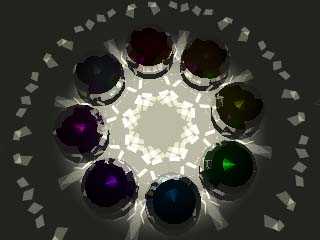

Hi,
Firstly, thank you Nathan, thankyouthankyouthankyou! An amazing patch, the
aplications of which has no limits, as demonstrated by the recent flurry of
photon map testing scenes.
Spider recently posted a photon map testing image that had reflective
coloured cylinders casting coloured reflections. I am working on a scene to
test reflective caustics too, but I have hit a problem. The scene consists
of coloured, reflective, faceted crystals (they are meshes composed of
triangles and smooth triangles). Here is an example of the red reflective
texture I am using:
#declare Mirrormetal_Red =
   material  // Mirrormetal Red
      texture
         pigment
            color rgb <1.0, 0.0, 0.0>
         finish
            ambient 0.0
            diffuse 0.079133
            phong 1.0
            phong_size 60.263333
            metallic 1.0
            reflection 0.8
The photon settings I am using are:
(Global Settings)
  photons
    gather 20, 100
    radius 0.1, 1 //[, <step size>]
    //[jitter <jitter amount>]
    //[autostop <angle>]
(Object Settings)
  photons {density .02
           reflection on
           ignore_photons
           //photons_pass_through
However, when I render the scene, the reflective caustics I get aren't
coloured, they are just plain white (I am using a white light to illuminate
the scene). What am I doing whong?
Thanks,
Equiprawn

From: Spider
Subject: Re: Help! Coloured reflections and Photons
Date: 17 Mar 1999 07:51:00
Message: <36EFA397.13CC68AF@bahnhof.se>
try and use this :
#declare fReflect =
finish {
	ambient 0.0
	diffuse 0.079133
	phong 1.0 //Not necessary. lower it .
	metallic 1.0
//	reflection 0.8 //nope.
#macro t_reflect(vColour) //vColour is a 3 post vector
texture {
	pigment { colour vColour }
	finish {
		fReflect
		reflection 	vColour
		ambient		vColour/10 //or something low.
#end
This will give you nice reflections on a solid shape.
notice me and I'll give source for my reflections image.
//Spider
                "Marian"
        By: "Sisters Of Mercy"
From: Nathan Kopp
Date: 17 Mar 1999 10:45:21
Message: <36EFCDC5.437945EA@Kopp.com>
Like Spider's code demonstrated, POV's reflection is not based on the pigment.
The color of the reflection is specified by the reflection keyword.
  reflection <1,0,0>  // this will reflect red
Of course, this is kind of annoying if you want to reflect a complex pattern.
I've got a suggestion for this... read about it in povray.programming.
-Nathan
From: Equiprawn
Date: 17 Mar 1999 11:41:55
Message: <36efdb53.0@news.povray.org>
Ken,
I'm not sure if that is the problem. The mesh object I'm using is not in any
CSG operations or anything like that, it is just in the scene. It produces
reflective caustics fine, but the caustics are not coloured. The meshes are
very reflective, and all have a strong colour (such as red 1 green 0 blue
0). I have posted a small pic to show what I mean. The reflected caustics
should be coloured by the objects as in Spider's scene, but instead they
stay white. I'm guessing it's one of my settings, but I'm not sure what to
do.
Equiprawn
