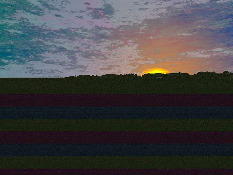

This is a three layer sky_sphere that I am working on for another scene.
The ground should be ignored for now. It isn't easy getting the transmit and
filter statements just right, and too, I have found that using an
interior/ior statement on a hollow sphere helps in getting the sun to light
the sky properly.
  Not quite there yet.
GrimDude

The clouds look a bit too solid. They should also have a red hue in a sunset
(dawn?) image. Of course, for this to look right, they would have to be 3D
media objects.
Still, it's a lot better than any sky image I've come up with. How did you
get this  yellow/violet banding near the sun?
sunset
>media objects.
>Margus
Well, to start with...
  I used a gradient pigment as pigment 1:
#declare Sun = pigment { gradient y
   color_map
      [0.000 color rgbt 2*<1, .4, 0, -1>]
      [0.0009 color rgbt 2*<1, .4, 0, -.25>]
      [0.0045 color rgbt <1, .4, 0, .2>]
      [0.05 color rgbt <1, .2, 0, .325>]
      [0.1 color rgbt <1, 0, -.05, .5>]
      [1 color rgbt <1, -.2, -.1, 1>] }
   scale 2 translate -1 rotate -85.5*x rotate 12.5*y }
  A z gradient would work just as well.
  Pigment 2 is intended to be a color filter to set up the sky atmosphere,
but I haven't used it right (obviously):
#declare Sky_Map = pigment { gradient y
   color_map {
      [0 color rgbft -4*<1,.8,-1,-1,-1>]
      [0.00045 color rgbft -4*<1,.4,-1,-1,-.25>]
      [0.00225 color rgbft 2*<-.25,-.4,.75,.75,-.2>]
      [0.025 color rgbft 2*<-.5,-.2,.5,.5,-.325>]
      [0.1 color rgbft 2*<-.75,0,.05,.25,-.5>]
      [1 color rgbft 2*<-1,.2,-.5,0,-1>] }
   scale 4 translate -1 rotate -85.5*x rotate 12.5*y }
  Finally, I put it all together with the clouds you can see:
sky_sphere
   pigment { Sun }
   pigment { Sky_Map }
   pigment { wrinkles turbulence 1.3 octaves 7 omega .6 lambda 4.5
      color_map {
         [0,.5 color color rgb <.9,.75,0> filter .8 transmit .25 color rgb
.5 filter .035 transmit .25]
         [.5,.7 color rgb .9 filter .035 transmit .25 color rgb 1 filter
.035 transmit .25]
         [.7,1 color rgb 1 filter .035 transmit .25 color rgb 1 filter .035
transmit .25] }
      scale <1,.254,10> } }
  AND, what really helps get the effect right:
sphere { 0,3600 texture { pigment { color rgbf 1 }
   finish { ambient 0 diffuse 0 reflection .4 specular .5 } }
   interior { ior 1.00229 fade_power .5 fade_distance 1000 }  hollow on }
AND
light_source { <0,-1000,0> color Pink media_interaction on rotate -85.5*x
rotate 12.5*y }
  I have found that MandarinOrange, for the light_source color, works best
(after I posted). I'm still playing, though.
  I hope that helps!
GrimDude
