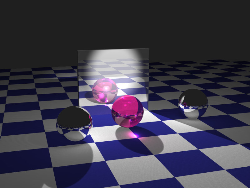

Here's another test scene (59596 bytes) using Nathan's photon mapping
implementation. Both reflective and refractive caustics can be seen. As
always, comments and helpful tips are welcome.
- Alan
Download 'rflcaust08.jpg' (59 KB)
Preview of image 'rflcaust08.jpg'

If anything at all (can not resist), the reflective spheres look like
they could have used a brighter reflective caustic to be obvious.
Was the same photon density used on all objects?
> - Alan
From: Nathan Kopp
Subject: Re: Another photon mapping test scene...
Date: 21 Mar 1999 16:22:07
Message: <36F562A1.73E6E9AF@Kopp.com>
This is really cool!  I want to point out that, though a spotlight is used,
the photon-tracing part treats it like a point light (so photons can light
up stuff outside of the cone of the spot light... that part of the code
isn't finished quite yet).
About the reflective caustics from the spheres... remember that the light
gets spread out (I can't think of an antonym for focused) very much, so
it really shouldn't be very bright (I like what you have here... it is
visible yet subtle).
-Nathan

  I used ambient 0 for the four object plus the floor box. Little too dark
for my tastes so I used a shadowless fill light in addition to the spotlight
shining onto the 'mirror'. I differenced the backside of the mirror during
an earlier test rendering because the reflective caustics were putting light
where I didn't want it to show when I was experimenting with additional
lighting placement.
  Thanks to everyone for the kind comments. Don't use my photon mapping
settings as gospel. I have tried to read all of Nathan's posts concerning
appropriate settings but I may have changed too many items at one time and
quite possibly went the wrong way...<s>. Many thanks to Nathan for his
fantastic work on implementing photon mapping into UVpov.
  I did find one shortcoming during final traces - I need more memory! I was
hitting the swap file much too soon with 64mb RAM. Here are the stats for an
800w by 600h, +am2 +a0.2, on a Pentium 200MMX.
Shadow Ray Tests:           360457   Succeeded:                63626
Reflected Rays:            3076492
Refracted Rays:            1433909
Number of photons shot:          2816131
Number of photons stored:        2098198
Priority queue insert:         287930609
Priority queue remove:         118863033
Smallest Alloc:                 28 bytes   Largest:         16384024
Peak memory used:        102953138 bytes
Time For Parse:    0 hours 25 minutes  48.0 seconds (1548 seconds)
Time For Trace:    2 hours 59 minutes  25.0 seconds (10765 seconds)
    Total Time:    3 hours 25 minutes  13.0 seconds (12313 seconds)

  Yes, the same density on all objects. I played around with the density and
didn't see much difference after a certain point (but I've forgotten which
point that was). I'll venture that it *might* be okay 'as is' since the
reflective spheres aren't being directly hit by the spotlight. Still, if I
can figure out how to increase the reflective caustic just enough to avoid
an overly long rendering time I might check it out.

  I had started this scene before I saw one of your earlier posts concerning
how the photon patch treats all lights as point lights. Some head-scratching
took place when I saw the reflective caustics of the 'mirrored' box appear
across the floor surface. I also saw the effect you spoke of when decreasing
the density of the photons, it gives the impression of soft lighting effects
coming off that same box.
  Thanks for your efforts, Nathan. Your comments, also, are invaluable as
it's so much trial and error for this humble user (yes, I do read all docs
on your pages).
- Alan

Date: 22 Mar 1999 20:42:38
Message: <36F6F188.DFF45624@aol.com>
What may be throwing me a curve about it, I happened to think, is that
real world objects are seldom perfect. This means there would usually be
more concentrated caustics as well as more diffuse showing up side by
side on the floor under the spheres (and bet you knew that already).
Perhaps a tiny amount of some slightly turbulent spherical normal would
suffice.
I hate to suggest things all the time but I've been posting here at the
newsgroups so long I tend to throw any remarks in. And now I'm noticing
that :)
