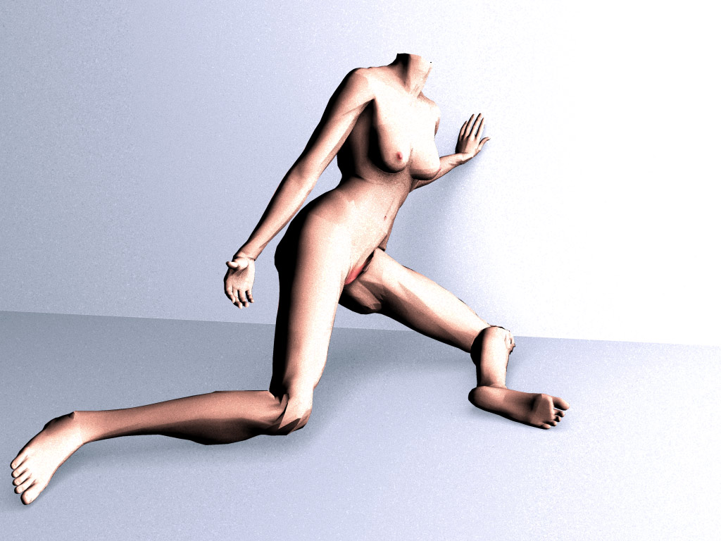

Now I have acrylics to hand, this is going to be first to make it over
to analog.
http://www.imbjr.com

IMBJR <no### [at] spamhere> wrote in
news:e1gmnugfa9p0k7ipttm4c2j7qnif5bv91e@4ax.com
generaly good, but using smooth triangles would be a good idea imho

On 8 Sep 2002 08:49:10 -0400, "Rafal 'Raf256' Maj" <raf### [at] raf256com>
Mesh2 objects don't appear to support that feature.
They do, it's the normal vectors and indices.
Ingo

"IMBJR" <no### [at] spamhere> a écrit dans le message de news:
etomnuofebrufqfu64rq0ujg33hqf7ar73@4ax.com...
Hmm, the newer version of a 3D format missing a basic feature that was
already in the previous version... If I were you, I'd check the pigment{}
statement, I heard that they forgot that "color" keyword in the 3.5 release
Kidding apart, it seems that your model has normals indeed (otherwise it
would appear much worse than than) but it looks as if the model was deformed
without taking normals into account.
G.

On Sun, 8 Sep 2002 19:23:33 +0200, "Gilles Tran" <git### [at] wanadoofr>
It wouldn't be the first time that's happened! (in other products that
is!).
I think OBJuvPOV may need some of its settings tweaking.
I eventually did come across a reference to normals in the mesh2
documentation - but I assumed OBJuvPOV was correctly dealing with
them. Also, I believe the facetted effect is not so bad if area lights
are not used - or so it would seem when switching between the 2 types
when prototyping.
They do.
But I like the hard edges in your picture.  It becomes a graphic
element in itself.
Fabien.

On Sun, 08 Sep 2002 21:22:15 +0200, Fabien Mosen
<fab### [at] skynetbe> wrote:
>They do.
Mmm, yup as normals I believe.
>element in itself.
I rather like them myself.
>Fabien.
jo6nnughi3ngrjml71a5h1h7mko6b11dfe@4ax.com...
> when prototyping.
Another possibility is that it's simply the result of both Poser's and
POV-Ray's specific shortcomings with mesh normals. Poser has its usual
problem with joints and POV-Ray may display facets outlines under some
lighting conditions (the explanation is in the docs). I did have some ugly
conversion problems with normals back in 1998 when I first tried early
OBJ -> mesh2 converters, but I think that OBJuvPOV is OK.
BTW, Jeremy Engleman did some experiments about facetted effects on nudes,
if you're interested.
http://art.net/~jeremy/cg/figure5.3.html#img
G.

"IMBJR" <no### [at] spamhere> wrote in message
news:e4cnnuoovdlfvgcaceejin4d40rcvj2315@4ax.com...
> >IMBJR wrote:
[snip]
> >element in itself.
I don't. I find they scream 'bad 3D' and detract from an otherwise impressive
texture and lighting setup. In fact, it is so impressive I would really like to
see a version with the normals corrected.
The composition is oddly interesting as well. Why headless?

"Batronyx" <bat### [at] alliancecablenet> wrote in message
news:3d7c1416$1@news.povray.org...
> > >IMBJR wrote:
> [snip]
> > >element in itself.
        I disagree. Yes, it might 'scream bad 3D' but if that was painted in oils,
the artist would be acclaimed for it. I like it as it was intended.
    ~Steve~

On Sun, 8 Sep 2002 23:00:44 +0200, "Gilles Tran" <git### [at] wanadoofr>
>> when prototyping.
They certainly have some charm about them.
>G.
From: IMBJR
Subject: Re: Headless nude (1/1)
Date: 9 Sep 2002 14:48:48
Message: <m4rpnug0c7p15bbo567purmog1nm2ffccp@4ax.com>
On Sun, 8 Sep 2002 22:22:05 -0500, "Batronyx"
>> >IMBJR wrote:
>[snip]
>> >element in itself.
The quotes around bad 3D are so necessary - since it's all very
subjective.
As for correcting the normals, I wouldn't know where to begin any
ideas? It's, remember, a mesh2 generated by OBJuvPOV.
The headlessness corresponds to the hand jesture towards the viewer -
as if she is asking 'why' or even 'where'.

that forward knee considerably more subtle. It's the thing bugging
me the most.
But then, Boris Vallejo is my favorite artist, I think
Van Gogh was suffering from astigmatism, and I'm convinced Picasso
was just a lucky pretender. So what do I know? :)
Several things come to mind. A combination of things may be required.
I haven't used OBJuvPOV, but if it has an option to increase the
smoothing angle of the normals that would be the first thing to try.
That seems to be the most obvious problem, around the arms. 3Dwin and
Crossroads both support this option. But I think only 3Dwin can deal
with the uv coords.
For that knee, you would almost have to pull it into a modeller and
manually tweak the points, into a smoother position. Same for the far
hip, but it could ride as is the shadows. Anim8or, for example, is free
and supports the .obj format. Point selection can be tedious but zooming
in and learning the virtual trackball helps a bunch. If you do this
you might want to save the uv coords as a separate file and re-apply them later.
UVMapper can assist with this.
As Gilles pointed out some of this may be due to the way POV renders
meshes, particularly at glancing angles. Double illuminate could help
a little, but I saw a post here some months ago suggesting that a second
copy of the mesh translated ever so slightly behind the first ( say .00001
or something like that) can also help overcome those artifacts.
Ok. I see 'where' more than 'why', but I see it now. Thanks.
>subjective.
Did you actually remove the head in Poser, or did you do it with some
external technique afterwards? It's my guess that you may have got the
head removal slightly wrong, resulting in the set of deleted normals not
being exactly the same as the set of deleted points, thus resulting in
the remaining normal_indices being associated with the wrong
face_indices.
Or possibly the wrong uv_indices being associated with the wrong
face_indices - I'm not 100% convinced that the facets are due to wrong
normals, they look to me like the wrong bits of the image map might be
being applied to each triangle. It's much easier the get the uv_indices
wrong if you modified the INC file created by OBJuvPOV, because they are
presented in a different order to that of the face_ and normal_indices.
The Poser-PVJuvPOV-POVRay combination usually gets the normals and uv
mapping correct, so if any unusual additional processing were performed
I'd tend to suspect that.
Mike Williams

On Tue, 10 Sep 2002 09:25:49 +0100, Mike Williams
>>subjective.
Do you know - I can't recall - but I strongly suspect it was done in
Poser and not OBJuvPOV.
>face_indices.
That surely would not effect the whole body.
It would appear that area lights really bring out this effect, normal
spotlights are far more forgiving.
