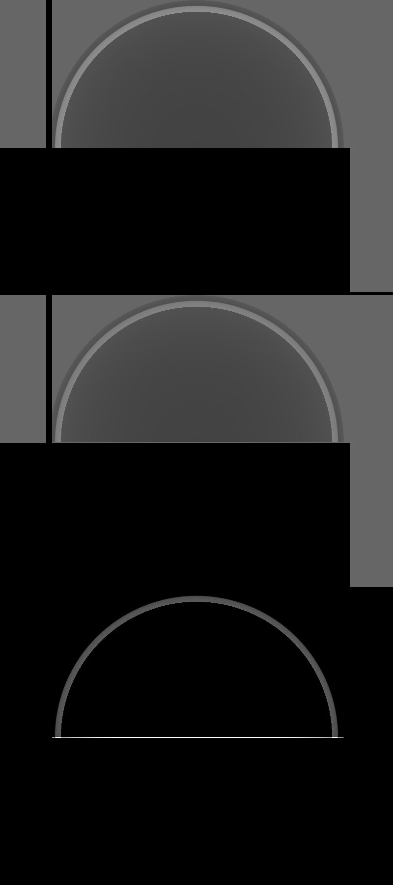

In trying to verify the media attenuation apart from the scattering I
set up a simpler scene with with two renders - light in at top, light
out at bottom. The attached image shows the difference at bottom. As I'd
expect the media_attenuation is getting applied only in the band where
the media is lit in the second and not to the background. In other words
attenuation looks to me to be working - when it's on - at least to a
first order.
> out at bottom. The attached image shows the difference at bottom...
I didn't think to try that simple image-differencing trick. I'll re-render some
images and test them in Photoshop, to double-check my theories.
