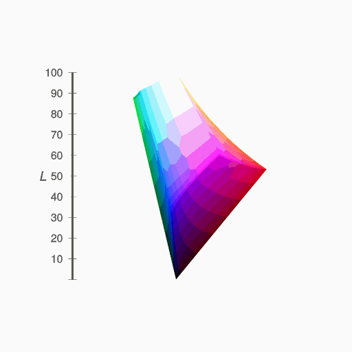

If I rotate the camera 90 degrees around the x axis, the isosurface
disappears.
Mike
Download 'cieluv_cube.mp4.mpg' (240 KB) Download 'cieluv_cube_disappear_01.gif' (97 KB)

What's weird is that the "missing" area perfectly fits the dimensions of
the bottom face of the cube used in the contained_by clause.
Anyway, I tried max_gradient 1000, and am now trying 10000. Not usre how
long it will take however.
Mike
Download 'cieluv_color_solid_cube_isosurface_05.png' (50 KB)
Preview of image 'cieluv_color_solid_cube_isosurface_05.png'

I don't think so. My camera is 17 units away from the origin, and the
contained_by area is only 1 unit wide.
(These values then get scaled by 200000.)
Mike
> disappears.
> Mike
I increased the max_gradient to 10000, and there seems to be no improvement.
Mike
