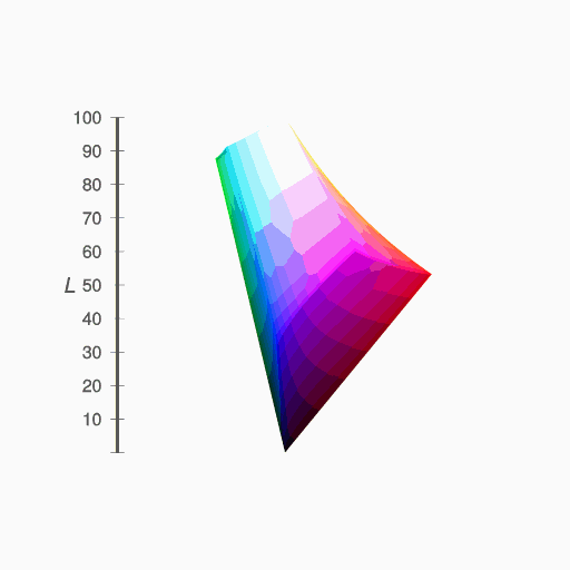

If I rotate the camera 90 degrees around the x axis, the isosurface
disappears.

My guess would be that on the "bottom" side of the shape, the function
has a much stronger gradient, so that when POV-Ray starts searching the
contained_by volume for intersection points starting from that side, it
finds incredibly huge values and thinks, "oh, I must still be VERY far
from the surface" -- advances a good deal, _skipping_ over the actual
body of the shape, and finds itself still outside, concluding that there
is no shape at all.
You must either increase max_gradient to fit even that portion of the
shape, or somehow find a way to get a nicer gradient down there.

What's weird is that the "missing" area perfectly fits the dimensions of
the bottom face of the cube used in the contained_by clause.
Anyway, I tried max_gradient 1000, and am now trying 10000. Not usre how
long it will take however.
Mike

Is there any chance the camera is ending up inside the contained_by
shape for the isosurface?
Bill P.

I don't think so. My camera is 17 units away from the origin, and the
contained_by area is only 1 unit wide.
(These values then get scaled by 200000.)
Mike

I increased the max_gradient to 10000, and there seems to be no improvement.
Mike
