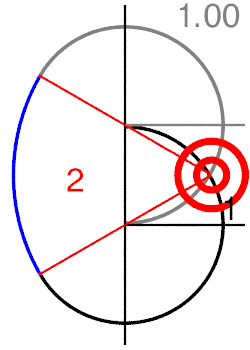

From discussion in p.general
So far the inner_radius of the lemon (center of inner circle as red target)
 is twice the largest radius of the spheres
Twice, inspired by Moss's egg
http://mathworld.wolfram.com/MosssEgg.html
Download 'ovus2d.gif' (1212 KB)
Preview of image 'ovus2d.gif'

Am 06.05.2016 um 21:13 schrieb Le_Forgeron:
Moss' Egg is a pretty poor justification for the "double radius" rule
though, as it /also/ follows the "equatorial tangent" rule.
Neat animation! A help to me in understanding POV-Ray's current Ovus
implementation.
Bill P.
