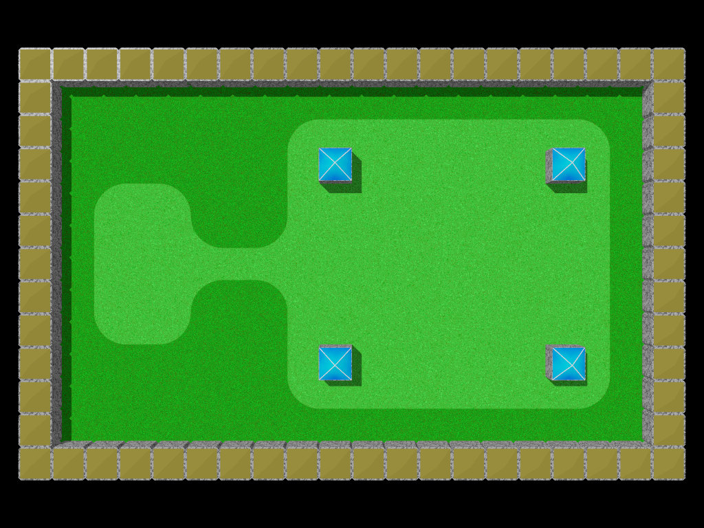

Hi(gh)!
I re-organized my POVigma project the way that distribution of floor
tiles, non-Oxyd stones (and later on also switches and doors), Oxyd
stones and other items are stored in ASCII "maps", such as:
1,1,1,1,1,1,1,1,1,1,1,1,1,1,1,1,1,1,1,1,
1,1,1,1,1,1,1,1,9,6,6,6,6,6,6,6,6,10,1,1,
1,1,1,1,1,1,1,1,6,6,6,6,6,6,6,6,6,6,1,1,
1,1,9,6,10,1,1,1,6,6,6,6,6,6,6,6,6,6,1,1,
1,1,6,6,6,3,1,2,6,6,6,6,6,6,6,6,6,6,1,1,
1,1,6,6,6,6,6,6,6,6,6,6,6,6,6,6,6,6,1,1,
1,1,6,6,6,4,1,5,6,6,6,6,6,6,6,6,6,6,1,1,
1,1,8,6,7,1,1,1,6,6,6,6,6,6,6,6,6,6,1,1,
1,1,1,1,1,1,1,1,8,6,6,6,6,6,6,6,6,7,1,1,
(Layer 1: floor tiles)
with meaning of the numbers as follows:
POVIGMA LEVEL LAYER 1 DOCUMENTATION: FLOOR TILES
Code  |  Description
          |  Friction
    0  | Black void, ball falls endlessly, life is lost
    1  | Grass floor
    2  | Grass/Light Grass floor, with Grass in quarter-circle centered
at SW
    3  | Grass/Light Grass floor, with Grass in quarter-circle centered
at SE
    4  | Grass/Light Grass floor, with Grass in quarter-circle centered
at NE
    5  | Grass/Light Grass floor, with Grass in quarter-circle centered
at NW
    6  | Light Grass floor
    7  | Light Grass/Grass floor, with Light Grass in quarter-circle
centered at SW
    8  | Light Grass/Grass floor, with Light Grass in quarter-circle
centered at SE
    9  | Light Grass/Grass floor, with Light Grass in quarter-circle
centered at NE
   10  | Light Grass/Grass soil, with Light Grass in quarter-circle
centered at NW
(friction to be added later on)
same with stones:
1,0,0,0,0,0,0,0,0,0,0,0,0,0,0,0,0,0,0,1,
(Layer 2: stones, doors, switches)
Code explanation:
POVIGMA LEVEL LAYER 2 DOCUMENTATION: STONES, DOORS, SWITCHES
Code  |  Description
    0  | none
    1  | grey marble, brass roof
and with Oxyd stones:
0,0,0,0,0,0,0,0,0,0,0,0,0,0,0,0,0,0,0,0,
0,0,0,0,0,0,0,0,0,21,0,0,0,0,0,0,20,0,0,0,
0,0,0,0,0,0,0,0,0,20,0,0,0,0,0,0,21,0,0,0,
(Layer 3: Oxyd stones)
Code explanation:
POVIGMA LEVEL LAYER 3 DOCUMENTATION: OXYD STONES
Code  |  Description
    0  | none
   20  | grey marble, blue white-finned roofs, not hit or covered again
because of mismatch, +0: blue symbol
   21  | +1: red symbol
   22  | +2: green symbol
   23  | +3: yellow symbol
   24  | +4: magenta symbol
   25  | +5: cyan symbol
   26  | +6: white symbol
   27  | +7: black symbol
   30  | +10: hit, uncovered but not yet matched (blinking question
mark), symbol codes accordingly
   40  | +20: hit, uncovered and matched, symbol codes accordingly
These "maps" are read from disk when parsing each frame and, if any
changes occur, are written back to disk afterwards.
Furthermore, the current direction of the ball's movement (degrees), its
speed (POV units/frame) and the clock value at the last change of these
two values are also stored in an ASCII file.
The rendering of the static scene works fine, but...
...I obviously just can't get right the logic conditions for collision
detection!
Here is what I cooked up until now:
#declare rows=0; // check for collision with any stone
#while (rows < LevelLength)
   #declare cols=0;
   #while (cols < LevelWidth)
     #warning concat("row: ", str(rows, 1, 0), ", col: ", str (cols, 1, 0))
     #if (layer2_array[rows][cols] = 1 | layer3_array[rows][cols] >= 20)
       #declare xmin=cols-0.35;
       #declare xmax=cols+1+0.35;
       #declare zmin=rows-0.35;
       #declare zmax=rows+1+0.35;
       #if (ballpos_next.x > xmin & ballpos_next.x < xmax &
ballpos_next.z > zmin & ballpos_next.z < zmax)
         #declare dir = 360-dir;
	#declare hit=1;
	#break
       #end
       /* #if ( < zmax & (ballpos.x <= xmin | ballpos.x >= xmax))
         #declare dir = 180-dir;
	#declare hit=1;
	#break
       #end */
     #end
     #declare cols=cols+1;
   #end
   #if (hit)
     #break
   #end
   #declare rows=rows+1;
#end
Each stone (Oxyd or non-Oxyd) essentially is a box of 1 by 1 by 1 units
defined with its lower left front corner at the origin.
Attached is the basic layout of the scene (lower left corner: <0, 0, 0>,
upper right corner: <20, 1, 13>), and when I start animating the ball at
a speed of 0.1 and starting angle of 60 degrees, first all goes fine,
the ball is reflected from the northwestern Oxyd stone (those with the
blue pyramidal roofs) and then heads towards the northern stone wall -
but shortly before it hits, a strange thing happens: the ball starts
moving parallel to the z axis and goes right through the wall rather
than being reflected!
What did I wrong? Do I have to post all include files such as pigments,
finishes, textures and objects for you to understand (and perhaps solve)
my problem?
See you in Khyberspace!
Yadgar
Download '2015-08-27 povigma level 1, take 7.jpg' (193 KB)
Preview of image '2015-08-27 povigma level 1, take 7.jpg'
From: Le Forgeron
Subject: Re: POVigma: I just can't get it right!
Date: 28 Aug 2015 12:46:08
Message: <55e09050$1@news.povray.org>
Hash: SHA256
Le 27/08/2015 21:45, "Jörg \"Yadgar\" Bleimann" a écrit :
> #if (ballpos_next.x > xmin & ballpos_next.x < xmax & ballpos_next.z
> > zmin & ballpos_next.z < zmax) #declare dir = 360-dir; #declare
> hit=1;
* that's seems to detect a pinball's hit: ball hitting a nail on its
center.
* 360-dir is not the opposite direction.
hitting a bumber to get the opposite direction: dir = (dir+180)%360
You should detect walls' hit, and there is horizontal walls and
vertical walls. Both are harder to handle with a single dir variable.
Horizontal wall, reflecting the vertical component.
Vertical wall, reflecting the horizontal component.
Assuming 0 is North, 180 is South, 90 is East.
Horizontal wall: 0->180, 180->0, 90->90, 270->270, 30->150, 80->100
Vertical wall: 0->0, 180->180, 90->270, 270->90, 30->330, 80->280

From: "Jörg \"Yadgar\" Bleimann"
Date: 28 Aug 2015 22:40:36
Message: <55e11ba4@news.povray.org>
Hi(gh)!
which would yield the formula; dir = 180-dir
equalling dir = 360-dir - or just dir = -dir
Meanwhile I found out that my conditions left out the (rare) case that
the z coordinate of the ball's position in the last frame before
"entering" a stone is equal to that of the stone's southern face... I
fixed this (and also re-activated the branch for the vertical walls) and
now it runs fine (see attached video)!
Thank you for motivating me!
Yadgar

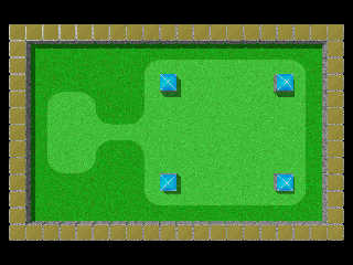

Date: 29 Aug 2015 12:02:06
Message: <55e1d77e@news.povray.org>
Hi(gh)!
And I thought I got it right... forget about it! While with speed=0.1
and starting angle=60 degrees all went fine, with speed=0.25 and
starting angle=340 degrees, at frame 219 the script starts to behave
bizarrely. As you can see in the attached video clip, the ball bounces
off a non-existing "horizontal" wall and then moves through the eastern
wall...
This is the collision detecting routine:
   #declare cols=0;
     // #warning concat("row: ", str(rows, 1, 0), ", col: ", str (cols,
1, 0))
       // horizontal obstacles
       #if (ballpos_next.x >= xmin & ballpos_next.x <= xmax &
ballpos_next.z >= zmin & ballpos_next.z <= zmax & (ballpos.z < zmin |
ballpos.z > zmax))
	#declare hit=1;
	#break
       #end
       // vertical obstacles
ballpos_next.z >= zmin & ballpos_next.z <= zmax & (ballpos.x < xmin |
ballpos.x > xmax))
         #declare dir = -dir;
	#declare hit=1;
	#break
       #end
     #end
   #end
   #if (hit)
     #break
   #end
#end
These are the values at frame 219:
xmin = 18.65
xmax = 20.35
zmin = 3.65
zmax = 5.35
ballpos = <18.6344,0,4.38568>
ballpos_next = <18.7199,0,4.15076>
Now let's check both #if conditions:
Horizontal ("west-east") obstacles:

 >= zmin & ballpos_next.z <= zmax & (ballpos.z < zmin | ballpos.z > zmax))
ballpos_next.x >= xmin TRUE
ballpos_next.x <= xmax TRUE
ballpos_next.z >= zmin TRUE
ballpos_next.z <= zmax TRUE
ballpos.z < zmin FALSE
ballpos.z > zmax FALSE
...so the following block should NOT be executed! But in fact it does!
Why? WHY?? WHY??? Am I too feeble-minded to understand this?!?
Yadgar

Instead, I now simply set cols and rows to LevelWidth and LevelLength
respectively after a detected collision, so that the nested loops both
come to an end...
...now the ball at least does not go through the wall anymore - but
instead, it is reflected in a somewhat strange way off the eastern and
southern bordering wall - see attachment!
This is not entirely absurd, as the border stones are beveled at the
corners, unlike the Oxyd stones - but the bevel angle is 45°, and the
ball hits always at angles which are not multiples of 45°, so it can not
be reflected this way...

the ball keeps bouncing off a non-existent "horizontal" wall and then
moves right through the eastern wall!
Yadgar
