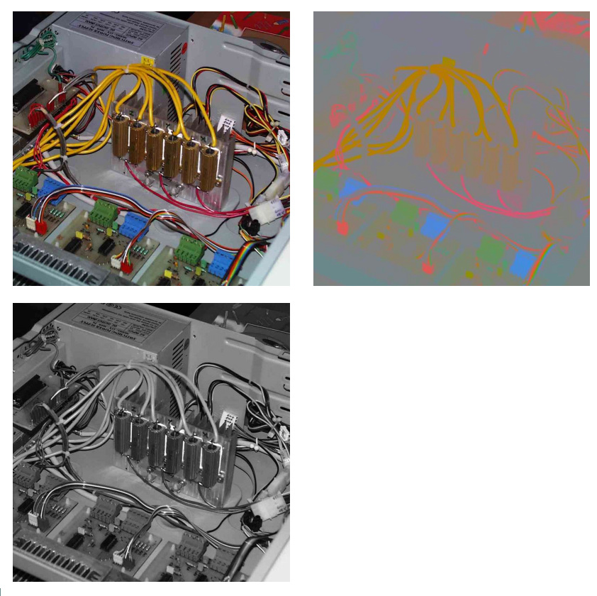

MPEG converts each RGB pixel into a YUV pixel, according to these formulae:
Y	= 0.299R + 0.587G + 0.114B
U	= 0.492(B − Y)
	= − 0.147R − 0.289G + 0.436B
V	= 0.877(R − Y)
	= 0.615R − 0.515G − 0.100B
Yellow (and white) against black will have transitions that are most
marked in the Y value (max value = .886) with lesser values in U and V
(-.436 and .1, respectively), while red's transitions max out at .299 in
Y, -.147 in U, and .615 in V.
The Y values are sampled at their original resolution, but U and V are
hacked in two both vertically and horizontally.  In other words, when
the MPEG coder goes to work on one of my IRTC frames, it turns the
320x240 R, G, and B frames into a 320x240 Y frame, a 160x120 U frame,
and a 160x120 V frame.  When the results are decompressed in your MPEG
player, the U and V frames are expanded back to 320x240, resulting in
both U and V being blocky-looking (or blurred) on decompression.
When the R, G, and B values are grabbed back out of the Y, U, and V, the
higher resolution of the Y data will result in higher-resolution
yellow-black edges, with a bit of funny coloring along them, while the
subsampled V data will result in blocky-looking red-black edges.
You can see this on TV; whenever there is a bright red object on the
screen, you'll see that the edge of the redness tends to stray from the
edge of the object.
Note that the MPEG standard does not require subsampling of the U and V
data, but subsampling doesn't affect the viewer's perception of the
results very often, so many MPEG encoders don't give you the option of
shutting it off.
It's how MPEG gets the first 50% of its compression, so it's fairly
important.

I have been playing with some RGB <-> YUV (for OCR)
I't very strange to see how little information it actually in the U and V.
The top-right image is composed form just the U and V data (Y fixed at 50%)
The bottom image is just the Y data.
Also note that green has a lot of effect on Y, because our eyes are more
sensitive for green.
I have seen the red blockiness very often in jpg's as well. There was a post
about it in binary-images, I think it was an image of red pencils. It is
possible to disable sub-sampling of the red channel in jpg's (at least with
gimp) don't know if it's possible with mpg.
It often can be solved by using a less saturated red, like: <0.8,0.1,0.1>
Download 'col_split_1.jpg' (204 KB)
Preview of image 'col_split_1.jpg'
From: Daniel Hulme
Subject: Re: Roller Coaster WIP 2 (MPEG1, DivX link)
Date: 23 Apr 2006 06:46:11
Message: <20060423114628.4ad698e9@mekanori.mon.istic.org>
> and V. The top-right image is composed form just the U and V data (Y
> fixed at 50%) The bottom image is just the Y data.
Another good way to see how little is in U and V is to split the image
up as you have done, and then blur one of the planes, and then
recombine them into a single image. Blurring the U and V planes has very
little effect compared to blurring the Y plane by the same amount.
Another fun demonstration is to combine the Y plane from one image with
the U and V planes from an unrelated image. The result looks much more
like the Y image.
There are lots of other sets of data you can do the same sort of demos
on, for example: the phase of the Fourier transform of an image conveys
much more information than the amplitude.
