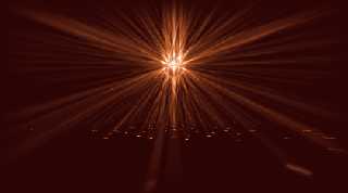

A while ago I did something similar, but instead of relying on photons
(which have the problem you mention with large numbers of facets), I
manually calculated the shapes of the reflected rays. The beams of light are
meshes filled with media, and the lights on the floor are actually polygons.
 - Slime

Hmm. The problem with polygons is that you can't easily project them onto
any complex shape (a box shaped room is about as complicated as you can
easily get).
A good solution would probably be: for every light source, for every facet,
create a duplicate light reflected around that facet, using
projected_through on the facet so that the light comes out of it as though
it were reflected from the original light source. Then you can get proper
shadows and lighting on complex surfaces.
 - Slime
 [ http://www.slimeland.com/ ]

Your beams seem to rotate at the same speed, as if the ball were a light
source rather than mirrors.
Mike Williams
They actually rotate faster than the disco "ball" itself, though it's hard
to see that. If you follow some of the dots of light on the floor, you can
see that they don't stay in the same positions relative to each other.
