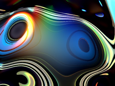

I opened the same .pov file I sent you and rendered it in pov3.1, and the
the image looks like the attached file. I did not even have Moray open. Does
your render look different from that?
About the clock, Moray's animation plugin produces an .avi directly, without
any clock values being set in POVray. So if you want to animate the scene in
POVray without using Moray, you have to set it up there yourself. My
animation was 8 seconds long and 15 frames per second (119 frames after
skipping the last one for smooth looping). You simply have to make the cone
rotate (around the z axis) 360 degrees in the time specified.
Steve Shelby

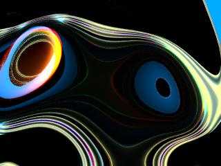

This is what it looks like on my machine. You can see it doesn't have as much of
a glow as your version. As far as I know I've got no strange settings in POV, I
only installed 3.1 a couple of weeks ago, so it's all set to defaults.

Oh, wow, big difference! I can't imagine what is causing it. I played around
with it in POV3.1 for a while, and came up with nothing. I'm not anything
close to an expert, though. Maybe you should pose the question on
povray.advanced-users.
Steve Shelby
news:405a86e7@news.povray.org...
much of
POV, I

"Steve Shelby" <ssh### [at] rexnetnet> wrote in message
news:405ae071$1@news.povray.org...
around
> Steve Shelby
Be careful posting to povray.advanced-users. It can be nasty in that room.
Ah, don't worry about it. I'm not really that bothered about using pov 3.1 any
more! :)
