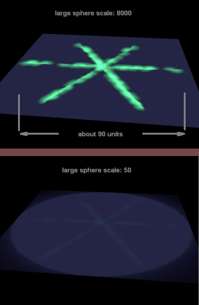

Thanks. This has been my most intense 'detective work' in a long time-- and I'm
still thinking about all of it! That sphere problem really bugs me, but I think
I've discovered something interesting about it.
I LIKE a challenge (??) :-O
From: Kenneth
Subject: Re: weird white stain with beta povray v3.8.0 (not with povray v3.7.0)
Date: 21 Jan 2022 09:55:00
Message: <web.61eac7cac82cc78e4cef624e6e066e29@news.povray.org>
Alain Martel <kua### [at] videotronca> wrote:
> WHY put that light so far away ? Why not use a much closer one...
I agree. And from more tests, I see that the sky-sphere's gigantic size has a
great deal to do with those super-bright radiosity patches-- which surprised me.
I ran an animation test using my posted 'simplified' code, while changing that
sphere scale from 8000 (which is not *too* large) down to 50. At 8000, the rad
patches are very bright; at 50, they are MUCH less bright. Currently, I don't
know why that should happen-- so I came up with yet another very simple test
scene of my own(!), which I post here. No light_sources in it. It produces the
same weird effect; change the sphere scale to see the difference. (I've also
attached an image example; if you can't see it here, it will nevertheless appear
in the 'image digest'.) Note that all of the scene's color values are purposely
very low.
What this tells me is that any scene with a media object in it, surrounded by
another larger rad-emitting object like that sphere, may show some unexpected
rad/media interactions somewhere, depending on the *scale* of the larger object
and the proximity of the media object to others. It's 'as if' the sphere is
causing brighter radiosity lighting from its colors, the larger it gets. I have
no other guess or explanation at this point. It makes me wonder if certain
radiosity values need tweaking, depending on how large a typical rad-emitting
'sky' sphere is (for example.)
Of course, one of the major reasons for the bright rad patches in all of the
posted scenes here is that the media objects are halfway-embedded in the
'ground'... so there's a proximity effect at work. But I wonder if subtle flaws
might also be occurring in 'typical' media/radiosity scenes that would be
similar to Warren's.
Date: 21 Jan 2022 11:10:04
Message: <61eadadc$1@news.povray.org>
Op 21-1-2022 om 15:52 schreef Kenneth:
> very low.

Is there a reason why the sky sphere has emission 1 ? It is a night
scene, so I would use emission 0 or emission0.01......
From: Alain Martel
Subject: Re: weird white stain with beta povray v3.8.0 (not with povrayv3.7.0)
Date: 21 Jan 2022 12:47:57
Message: <61eaf1cd$1@news.povray.org>
Emission 1 and rgb value of 0.1.
If it was rgb 1, then, a small emission value would be required.
From: Alain Martel
Date: 21 Jan 2022 12:54:13
Message: <61eaf345$1@news.povray.org>
Le 2022-01-21 à 09:52, Kenneth a écrit :
> // the large sky-sphere
> sphere{0, 1
> pigment{rgb .1}
>      finish{ambient 0 diffuse 0 emission 1}
>      scale 8000 // change to 50
>     // hollow on // does not seem to be necessary-- the media objects and
>                  // rad patches show up anyway
>      no_image
Have you tried to replace that large sphere with a sky_sphere ? Or even
a simple background statement if the pigment is solid ?
Some options :
background{ rgb 0.1 }
sky_sphere{
	pigment{ rgb 0.1 }
sky_sphere{
  pigment{plnar{
	[0 rgb 0.1]
	[1 rgb 0]
From: Kenneth
Date: 23 Jan 2022 12:45:00
Message: <web.61ed93d0c82cc78e4cef624e6e066e29@news.povray.org>
> > sphere{0, 1
> > pigment{rgb .1}
> >      no_image
> Some options :
> sky_sphere{
>  pigment{ rgb 0.1 }
Good suggestions. I tried both of those as a substitute for the large sphere--
and now there are NO bright rad-patch artifacts, in either case! So that sphere
(and its scale) seems to be causing a real/mysterious problem.
I tried one more simple test of that sphere: *creating* it with a radius of 8000
vs. *scaling* it to be so. But that didn't solve the problem.
Thanks Alain; this result *might* indicate a bug, regarding use of such an
actual sphere along with radiosity's 'media ON' switch.
From: Kenneth
Date: 24 Jan 2022 03:10:00
Message: <web.61ee5de4c82cc78e4cef624e6e066e29@news.povray.org>
Well, I spoke too soon. The reason I didn't see any patches-- or any rad/media
interaction at all-- was because my sky_sphere color and emission color were
just too dim to produce them. In my most recent test code posted earlier, use
the sky_sphere at rgb 0.1, and try emission 1*<0.1,1.0,0.1> to see the media
cylinders, then emission 250*<0.1,1.0,0.1> to see the bright patches again.
So that media object being half-embedded seems to be the real problem... along
with rad's 'media ON' switch.
But I find it strange that the sky_sphere produces its own particular radiosity
brightness, versus the enclosing-sphere object imparting its *variable* rad
brightness depending on its size.
A mystery for now.
From: Alain Martel
Date: 24 Jan 2022 08:01:33
Message: <61eea32d$1@news.povray.org>
> A mystery for now.
New suggestion :
Scale your media container by <0.5, 1, 1> and move them up so that it is
entirely above the surface. Even leave a tiny gap between it and the
surface.
