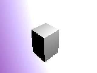

Hi There is something that I try to understand every once in a while with
povray:
I am trying to have a sky sphere with gradient but still with an alpha layer
fully transparent in the end image. How do you do that?
I try using two rgbt colors, both with a transmit value of 1 as entries to the
colormap.
If I do that,  only the last entry of color map of my gradient will be used as
if the the first entry had never existed. so it seems like the transparency is
baked into the color for each entry. could there be an option to make it so that
if the first entry has transmit 1 its color is still retained and all
transparencies
only applied in the alpha layer?

Actually it's not the color of the last entry, it happened to be the color of my
background too. If I remove the background, I get a completely black skysphere!
So what is happening, Are spy sphere totally ignoring the separation between
colors and alpha?

Here it is:

You are specifying a transmit of 1, which means that the ray must goes
straight through the sky_sphere, without interacting with the colour.
Hence it get to the background... whose default is black unless you
specify another.
I'm afraid we are entering the big discussion in image format: does a
transparent pixel have a colour (or: is the rgb part of an alpha-enabled
image format pre-multiplied or not in regard to alpha (and gamma, it's
far more fun with gamma in the equation)).
The problem is that different format have different answers.
(and they might be all valid, up to their tenants)
Maybe you want to replace rgbt with rgbf (it give a colored background
with some transparency with +UA (and using a format which support alpha,
such as png)) ?
Or keep rgbt, but reduces t to 0.5 ?
I do not get what you are trying to achieve with such transmitting
sky_sphere.

I'm working with PNG and I want my Blender exporter to give me the proper alpha
to allow compositing, and other things just like the internal renderer outputs:
it allows a gradient for color of the background sky (blend sky option) but the
alpha is  still cutting the whole sky as *fully* tranparent. So in Pov an alpha
of 0.5 will not solve the problem as I'll have only partial transparency.
And the first solution you suggest, won't work either, should I use Filter for
the background, I get no transparency at all. Maybe that's what is broken? So I

With filter at 1 on the sky_sphere and NO background, with beta 39, I
got the attached pictures.
sky_sphere {
 pigment {
  gradient y
  color_map {
   [0.0 rgbf<0.33, 0, 0.528, 1>]
   [1.0 rgbf<0.481, 0.774, 0.645, 1>]
global_settings {
 max_trace_level 7
 ambient_light rgb<0, 0, 0>
 //  background { rgbt <1,1,1,0.5>}
A good Manager will take you
through the forest, no mater what.
A Leader will take time to climb on a
Tree and say 'This is the wrong forest'.
Download 'skysphere.png' (9 KB)
Preview of image 'skysphere.png'
