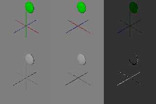

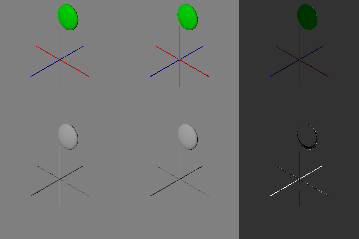

---  png gamma issue.
I've mentioned elsewhere POV-Ray makes a pretty good viewer for >8 bit
channel output files. While using POV-Ray as viewer it generates an
output file if not suppressed. On a whim - aka asking for trouble - I
decided to compare the original rendered output file with the viewer
output file - these should match. They don't.
First looking at the POV-Ray png default color output and immediate
input as an image_map in a viewer.
The short story is png output is hard coded to srgb unless overridden by
a File_Gamma setting somewhere. However, this hard coded output doesn't
trigger the generation of the correct srgb, encoding, information block
in the png file, but rather a power law 2.2 gamma block. When the
generated image is read it's done using a gamma correction which doesn't
match that used to generate the image.
What this means in practice is shown in the attached image top row where
the differences are multiplied by 50. The differences are small, but
certainly there.

Aside: The bottom row of the attached image shows the greyscale
differences which include the default png gamma out issue above - plus
apparently more...

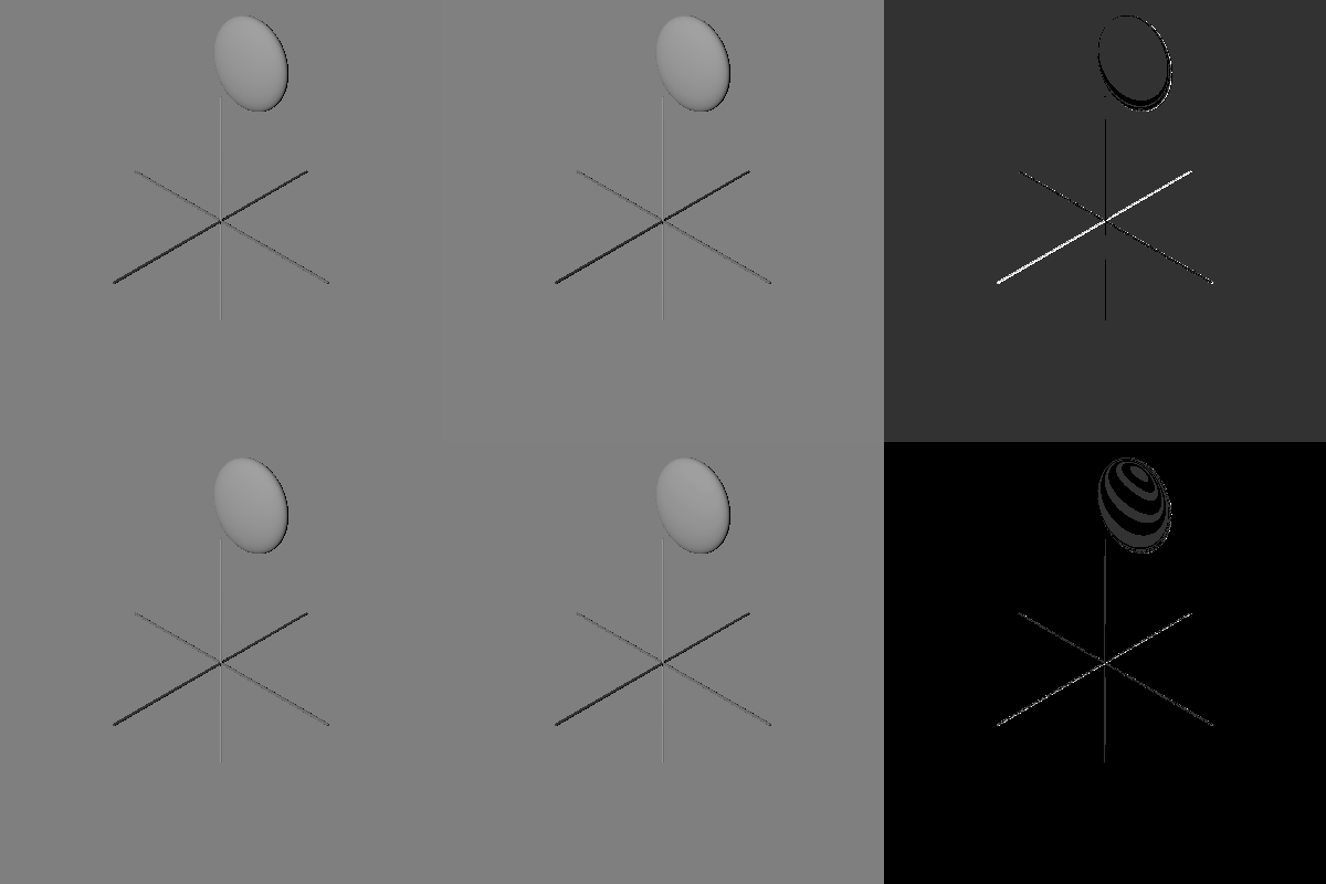

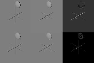

With this update above the color render and viewer v3.8 outputs match
whether File_Gamma explicitly set to srgb or not.
The grey scale too is better as shown in the attached image. The top row
less the fix above and the bottom row with the fix. There is still
something off related to non-grey defined colors in the render.pov
result leading to different between render and viewer by as much as
11/255(1). I don't understand what is happening there as yet...
