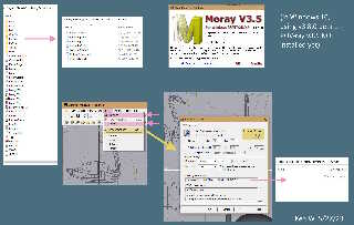

Yes, I see that Alt-F9 brings up the 'Render options' window. I didn't know
about that.
But I'm still having no luck exporting. *However*, I have not yet installed
POV-ray v3.5. (just v3.8.0 beta 1).
It appears that I am doing exactly what you suggest, but no luck. In Moray's
'Render' menu, I have tried both F9 and Ctrl-F9, but nothing happens and no SDL
file shows up in the "POVscn' folder.
I do understand that Moray only works 'in tandem' with v3.5 for *rendering*, so
I was not expecting an actual render to occur; but I was hoping that I could at
least export the scene as SDL, somehow.
My current trials are like this:
I open one of Moray's included .mdl demo scenes, like 'Swan' (I've also tried
'Coffeecup'.) Then, without changing anything in the scene or menus, I try
exporting with F9 or Ctrl-F9. Nothing. :-(  Of course, F9 is a RENDER button, so
I was not surprised by the error message that showed up, "Cannot start POV-ray.
Please start POV-ray manually and try again."
(BTW, in the 'Render options' window, I tried un-checking the 'Active Renderer'
box-- but it refuses to be un-checked. As if that has any meaning for the
problem!)
I am going to download POV v3.5, if it is still available on Github. I have the
suspicion that it is required, even for the export of a file. Otherwise, I have
no clue as to why the export feature is not working.

Here's something interesting: As an experiment, I changed Moray's default
library path for finding the POV-ray pvengine.exe file-- to my v3.7.0 install,
and also to v3.8.0 beta 1. (I chose the 32-bit versions of each in the POV 'bin'
folder).
Then in Moray's 'Render' menu, when I press either 'Raytrace' (F9) or 'Render',
POV-ray automatically starts up! But nothing is actually rendered, as expected--
Moray's render-image pane is black; nor does the Moray scene show up in POV-ray
as SDL.
It was worth a try though, just to see what would happen.

Op 28/05/2023 om 18:14 schreef Kenneth:
> Meanwhile, I hope I can find POV-ray v3.5 available somewhere...
It is available at the POV-Ray site itself:
https://www.povray.org/ftp/pub/povray/Old-Versions/Official-3.5/Windows/
Subject: Re: Moray 3.5 and Pov-ray 3.5 both run on Windows 11
Date: 29 May 2023 02:14:15
Message: <647442b7$1@news.povray.org>
Op 28/05/2023 om 17:39 schreef Kenneth:
> Well, apparently it is no longer available for download there?? v3.7.0.0 is the
> earliest version available. Unless I am looking in the wrong place...
> https://github.com/POV-Ray/povray/releases
It is available at the official POV-Ray site:
> folder).
> as SDL.
Yes, I had the same happen to me indeed.
From: Kenneth
Date: 29 May 2023 10:25:00
Message: <web.6474b501cfce83799b4924336e066e29@news.povray.org>
Great! Many thanks. Just out of curiosity, is there an obvious or official link
to that page, somewhere in the newsgroups?
I wonder if there are even earlier versions available, tucked away in some
equally obscure(?) location.
[JR wrote:]
> if you can find someone to build it for you/your Windows machine, I have
> the 3.50c source to hand.
Thanks for the offer. Personally, I know next to nothing about compiling a
program for Windows. Or even what kind of older(?) tools and tricks that might
be required for compiling such 'ancient' v3.50 source code, ha.
