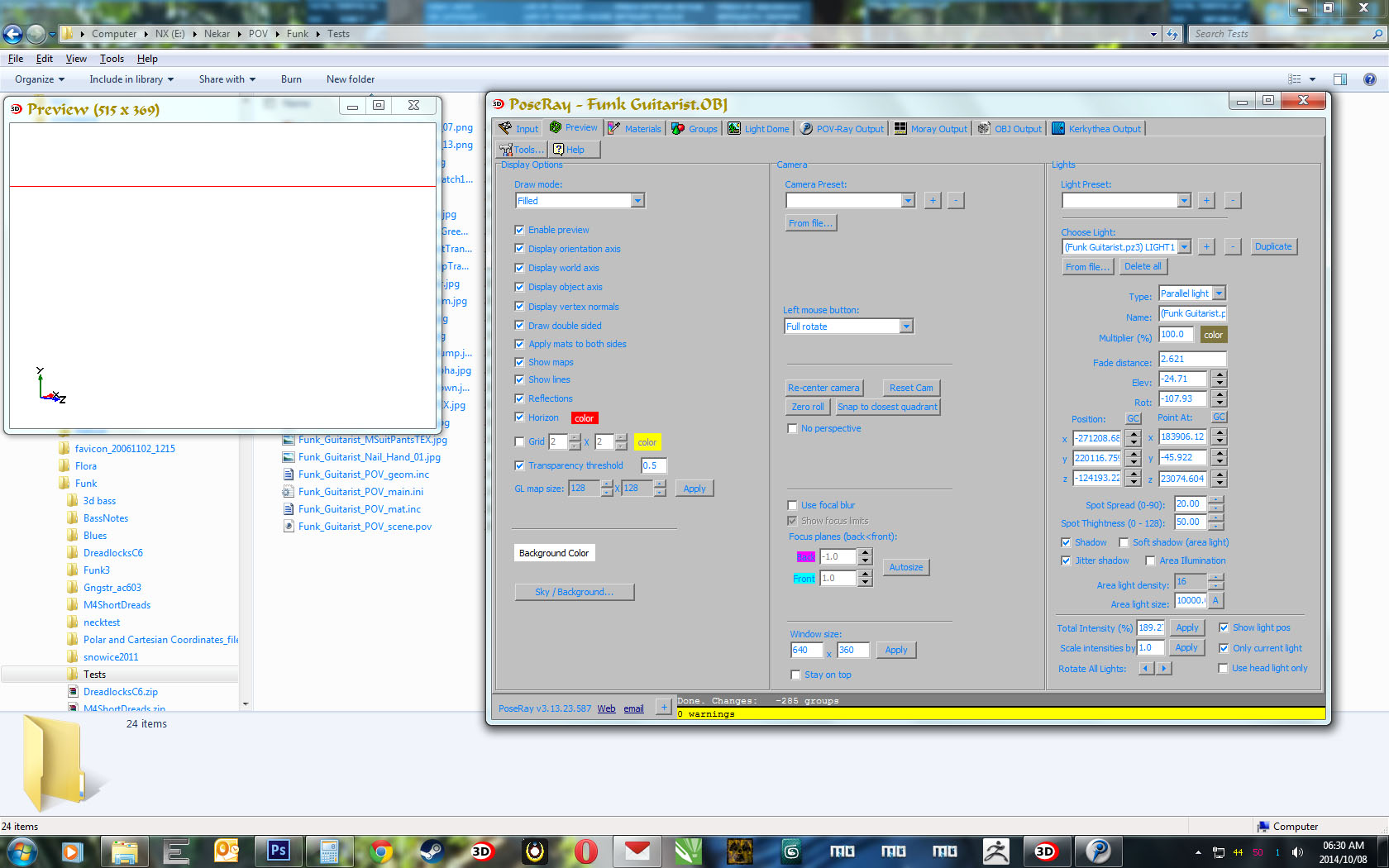

I would like my units to be in meters so Then my scaling would have to be
2.62128.
Attached is a screenshot of what thedisplay looks like after I loaded the
scene into PoseRay.
Thinking that maybe the scene is too much to handle, I disabled SSLT and
radiosity, resulting in very dark renders. Today I tried the default quick
sslt setting and it rendered fine in Pov-Ray, but still no display on
PoseRay. I've tried with and without hardware acceleration with no change.
Removing the lights asnd adding others also makes no difference.
I need to see where each texture is on the model for my scene and now I
can't because PoseRay doesn't show anything.
I have a 2.6 GHz Q9400 Intel QuadCore with 4Gb RAM and a 1Gb ATI 5770 and
I am running Windows7 Ultimate.
-Nekar Xenos-

Nekar,
Could you post the geometry info? This is found by clicking on the +
button at the bottom by the email link and selecting geometry tab.
Select all the text there, copy it (CTRL+C) and paste it as a reply. I
am suspecting something is seriously wrong with the size of the scene
that is not allowing PoseRay to preview it properly. I noticed that the
light positions on your screenshot are really large if they are in meters.
Also did you try to remove all the lights and just let PoseRay use its
camera light?
Maybe your scene is off-camera. Press reset camera in the camera section
of the preview tab. This should show the entire scene. Maybe the scene
is covered by a wall, dome or floor. Uncheck draw double sided in the
display options section of the preview tab. Poser does not preview both
sides of the geometry and that may lead to different previews in Poser
and PoseRay.
One unrelated note about using a meter scale: POV-Ray, at least 3.5, had
some issues with shadows if the scene was just a few units across. That
is why I use inches or cm for my scenes to avoid this issue. This may
not be a problem anymore with 3.6. This is unrelated but something to
keep in mind if shadow artifacts show up.
FlyerX

>> Thanks, FlyerX
>> be 2.62128.
>> the scene into PoseRay.
>> quick sslt setting and it rendered fine in Pov-Ray, but still no display
>> on PoseRay. I've tried with and without hardware acceleration with no
>> change. Removing the lights asnd adding others also makes no difference.
>> and I am running Windows7 Ultimate.

This led me to the source of the problem. The scene was about a cubic
kilometer in size. I exported the whole scene including ground plane and
universe. By going through everything and deselecting any unwanted stuff
everything worked perfectly. It's a long time since I've done any poser
stuff...
Thank you.
