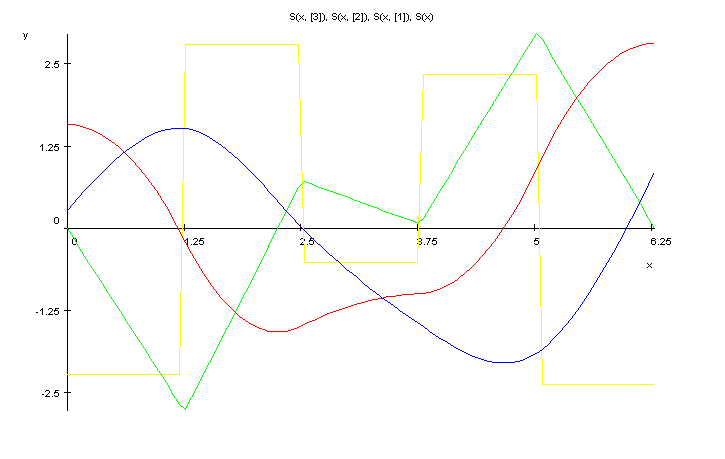

I've attached(sorry in advance for doing that in a non-binary group)
a little picture showing an example spline with 6 controlpoints and 5
intervals. The spline itself is shown in blue, the 1st der. in red,
the 2nd der. in green and the 3rd in yellow.
