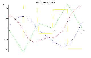

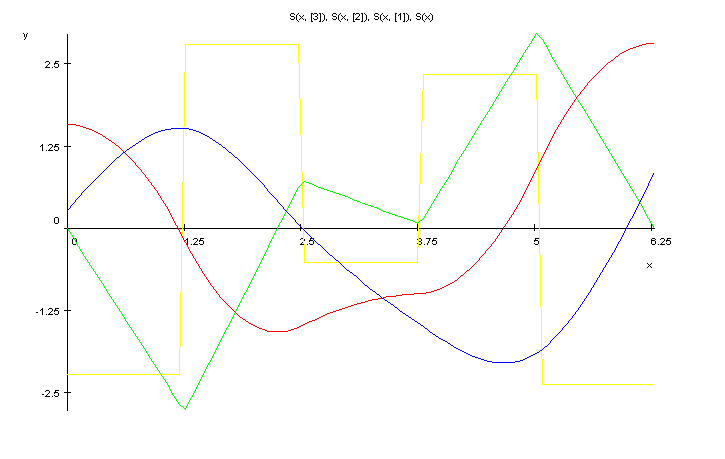

I've attached(sorry in advance for doing that in a non-binary group)
a little picture showing an example spline with 6 controlpoints and 5
intervals. The spline itself is shown in blue, the 1st der. in red,
the 2nd der. in green and the 3rd in yellow.
The process of getting the coefficients is explained on the wolframpage.
Basically, you have to solve a linear equation system which is given by
your continuity-constraints for the function and the derivatives.
I hope this helps a bit,
Thies
Download 'Cubic-Spline-Example.png' (8 KB)
Preview of image 'Cubic-Spline-Example.png'
