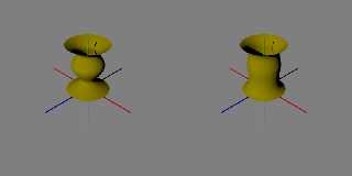

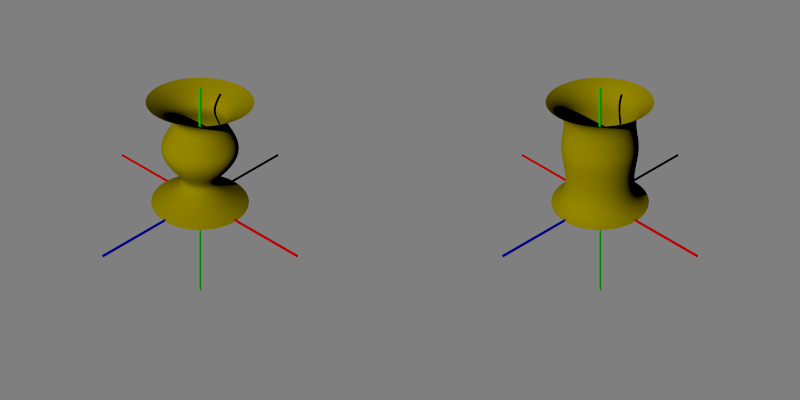

3) For the attached image the sor is on the left and the lathe on the
right. I'm using yuqk, so the solvers are changed from POV-Ray proper.
     5
     <+1.5,-0.1>
     <+0.4,0.0>
     <+0.3,0.5>
     <+0.4,0.9>
     <+1.5,1.1>
sor
21.43user 0.03system 0:06.11elapsed
25.28user 0.02system 0:07.06elapsed  (sturm)
lathe  (cubic_spline)
26.33user 0.02system 0:07.27elapsed
26.30user 0.02system 0:07.31elapsed  (sturm)
