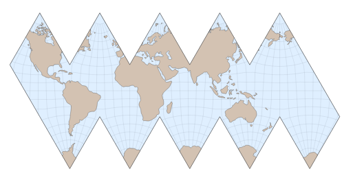

I am going mad trying to project image maps onto polygons that are not in the
x-y plane or plumb to the y axis. I have 20 equilateral triangles forming a
typical D20 shape (regular icosahedron). I have the XYZ coordinates for the
points so all I have to do is create each triangle using sets of the 32
vertices. BUT . . . .
I cannot work out how to project the 20 image_map pigments properly. Image_map
pigments only seem to work on polygons normal to the Z axis and left corner at
0,0 XY
The suggestion that I create each triangle at 0,0 and then translate/rotate them
to the icosahedron would be just fine if i had those numbers. (I do not)
There must exist another way, as the current limitation is ludicrously
un-useful. Everybody aplying pictures to polyhedra would have exactly the same
problem.
What am I missing?
Is it possible to translate the triangle by translating its individual points?
That I might be able to do, but I can't work out how.
The ultimate goal is a Dymaxion type world map on an Icosahedron.
Download 'test-ico.png' (62 KB)
Preview of image 'test-ico.png'

<https://wiki.povray.org/content/Reference:Image_Map>
once you've created the image_map, you'll want to scale it to correct
proportions, eg if the source is 1920x1080, the scale ought to read
'<1.92,1.08,1>'.
ok, I'll stop here 'coz confused, above you wrote "I have the XYZ coordinates
for the points".
if you do have those coords, create yr object in position (near origin, "image
is projected onto the object as though there were a slide projector somewhere in
the -z-direction"), then translate.  hth.

In your case, it may be OK to use the spherical mapping for your
image_map, making sure that the isocahedron is modelled centred at the
origin. For that you need a single image showing every faces. Ideally,
that image will have a 2:1 aspect ratio.
Add «map_type 1» at the beginning of the image_map statement. There will
be some distortion, but, in this case, it'll be minimal.
Another option is to use UV mapping. For that, you need to declare your
icosahedron as a mesh object.
If that's not an option, like you have individual images for each faces,
you need to create each triangles at the origin parallel to the X-Y
plane, rotate them correctly, then translate them to their final location.

My first thought is use a mesh2 with UV mapping. It may be a little hard to do
it by hand. But you only have 32 points to worry about. Try looking at the mesh2
documentation to see if you want to try that.

Hi again Molly
I've now made a couple of GitHub repositories that may be useful for you.
Here you can find the vertices and the triangles that you need:
https://github.com/t-o-k/POV-Ray-icosahedron
Here you can see how you can UV-map parts of an image onto a mesh2:
https://github.com/t-o-k/POV-Ray-UV-mapping-of-mesh2
And here you can download images suitable for being mapped onto an icosahedron:
https://solarviews.com/cap/ico/icoearth.htm
