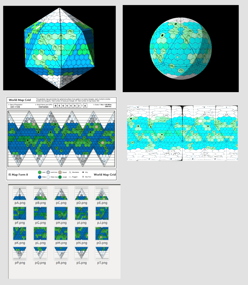

From: Molly-J
Subject: Re: image_map to tilted and rotated triangle centered and scaled
Date: 29 Mar 2022 16:15:00
Message: <web.624367b3ccfe29009cded0992eac0897@news.povray.org>
Thank you everyone for all that help.
I worked out how to do it after re-reading your posts carefully. I had to break
out the geometry/trigonometry skills to derive the angles from xyz coordinates.
there seems to be no other way.
unless there is . . . .
Is there a povray function that returns polar coordinates of a surface's normal?
eg. create a polygon my_polygon at xyz xyz xyz and then ask--
let lat/lon = normal(my_polygon)
Download 'tutorial-00.png' (505 KB)

Date: 31 Mar 2022 14:25:00
Message: <web.6245f0deccfe29001f9dae3025979125@news.povray.org>
You might be able to use
f_th(x,y,z): f_th() is a function that is only useful when combined with other
surfaces. It produces a value which is equal to the theta angle, in radians, at
any point. The theta angle is like the longitude coordinate on the Earth. It
stays the same as you move north or south, but varies from east to west. Also
look at f_ph and f_r
and
f_ph(x,y,z): When used alone, the PH function gives a surface that consists of
all points that are at a particular latitude, i.e. a cone. If you use a
threshold of zero (the default) this gives a cone of width zero, which is
invisible. Also look at f_th and f_r
in Functions.inc
https://wiki.povray.org/content/Reference:Functions.inc
From: Tor Olav Kristensen
Date: 2 Apr 2022 20:50:00
Message: <web.6248ee41ccfe29006d7cc5a589db30a9@news.povray.org>
"Molly-J" <nomail@nomail> wrote:
> I am going mad trying to project image maps onto polygons that are not in the
> x-y plane or plumb to the y axis. I have 20 equilateral triangles forming a
> typical D20 shape (regular icosahedron). I have the XYZ coordinates for the
> points so all I have to do is create each triangle using sets of the 32
> vertices. BUT . . . .
> I cannot work out how to project the 20 image_map pigments properly. Image_map
> pigments only seem to work on polygons normal to the Z axis and left corner at
> 0,0 XY
> The suggestion that I create each triangle at 0,0 and then translate/rotate them
> to the icosahedron would be just fine if i had those numbers. (I do not)
> There must exist another way, as the current limitation is ludicrously
> un-useful. Everybody aplying pictures to polyhedra would have exactly the same
> problem.
> What am I missing?
> Is it possible to translate the triangle by translating its individual points?
> That I might be able to do, but I can't work out how.
> The ultimate goal is a Dymaxion type world map on an Icosahedron.
Hi again Molly
I've now made a couple of GitHub repositories that may be useful for you.
Here you can find the vertices and the triangles that you need:
https://github.com/t-o-k/POV-Ray-icosahedron
Here you can see how you can UV-map parts of an image onto a mesh2:
https://github.com/t-o-k/POV-Ray-UV-mapping-of-mesh2
And here you can download images suitable for being mapped onto an icosahedron:
https://solarviews.com/cap/ico/icoearth.htm
Tor Olav
http://subcube.com
