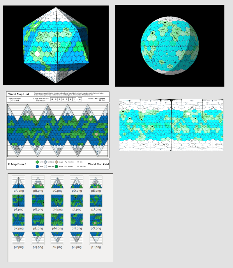

Thank you everyone for all that help.
I worked out how to do it after re-reading your posts carefully. I had to break
out the geometry/trigonometry skills to derive the angles from xyz coordinates.
there seems to be no other way.
unless there is . . . .
Is there a povray function that returns polar coordinates of a surface's normal?
eg. create a polygon my_polygon at xyz xyz xyz and then ask--
let lat/lon = normal(my_polygon)
Download 'tutorial-00.png' (505 KB)

You might be able to use
f_th(x,y,z): f_th() is a function that is only useful when combined with other
surfaces. It produces a value which is equal to the theta angle, in radians, at
any point. The theta angle is like the longitude coordinate on the Earth. It
stays the same as you move north or south, but varies from east to west. Also
look at f_ph and f_r
and
f_ph(x,y,z): When used alone, the PH function gives a surface that consists of
all points that are at a particular latitude, i.e. a cone. If you use a
threshold of zero (the default) this gives a cone of width zero, which is
invisible. Also look at f_th and f_r
in Functions.inc
https://wiki.povray.org/content/Reference:Functions.inc

Hi again Molly
I've now made a couple of GitHub repositories that may be useful for you.
Here you can find the vertices and the triangles that you need:
https://github.com/t-o-k/POV-Ray-icosahedron
Here you can see how you can UV-map parts of an image onto a mesh2:
https://github.com/t-o-k/POV-Ray-UV-mapping-of-mesh2
And here you can download images suitable for being mapped onto an icosahedron:
https://solarviews.com/cap/ico/icoearth.htm
Tor Olav
http://subcube.com
