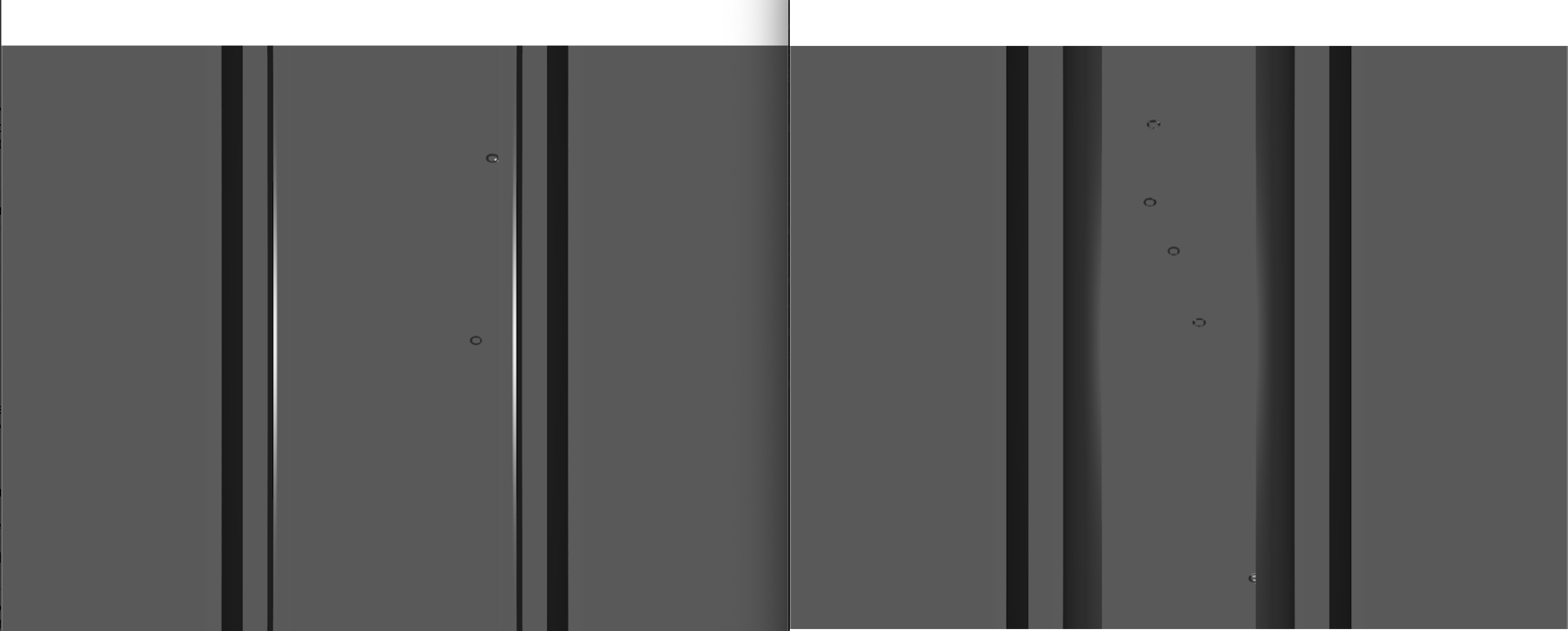

2). Rendering Issue and the appearance of dark regions after animation
rendering:
My next question pertains to a rendering issue I have run into.  I reformatted
my previous script with the generous input of forum users.  Here I have defined
each region of my setup in a more efficient manner that I was perviously.  In my
attached file, I am simulating air bubbles trapped in a gel housed within a
glass tube.  Outside of this tube is a cylinder of water and then a cylinder of
plexiglass.
When I first rendered my setup, everything was looking good, and so I decided to
run it as an animation, rotating the bubbles around Y axis.  However, when I ran
the animation, the boundary between the glass and water appeared to be speckled,
which immediately made me think of an overlapping surface issue.  I addressed it
by adding an "epsilon" to the radius of my water cylinder's inner surface and
ran it again.  While the speckled surface issue was resolved, a large portion of
my cylinder is being rendered as a dark region, and this region will not go away
no matter what I do, and I cannot recreate the original bright region.  I also
tried turning off the fade and this did not help.
Can anyone help me troubleshoot this issue?
Thank you all for your support and insights!

PlexCyl
Download 'screenshot 2021-12-03 at 13.33.01.png' (338 KB)
Preview of image 'screenshot 2021-12-03 at 13.33.01.png'

It must be a Friday because the script I included has the definition:
tube_router-epsilon
instead of
tube_router+epsilon
I changed my script out of frustration to try to recreate my previous effects.
The issue I am experiencing happens when I have correctly defined the water's
inner surface as:
tube_router+epsilon
Sorry for the confusion on my part.
Sincerely,
Bubble_person
