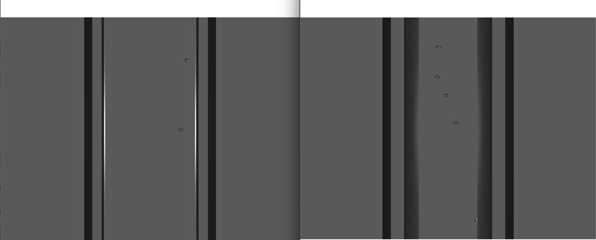

2). Rendering Issue and the appearance of dark regions after animation
rendering:
My next question pertains to a rendering issue I have run into.  I reformatted
my previous script with the generous input of forum users.  Here I have defined
each region of my setup in a more efficient manner that I was perviously.  In my
attached file, I am simulating air bubbles trapped in a gel housed within a
glass tube.  Outside of this tube is a cylinder of water and then a cylinder of
plexiglass.
When I first rendered my setup, everything was looking good, and so I decided to
run it as an animation, rotating the bubbles around Y axis.  However, when I ran
the animation, the boundary between the glass and water appeared to be speckled,
which immediately made me think of an overlapping surface issue.  I addressed it
by adding an "epsilon" to the radius of my water cylinder's inner surface and
ran it again.  While the speckled surface issue was resolved, a large portion of
my cylinder is being rendered as a dark region, and this region will not go away
no matter what I do, and I cannot recreate the original bright region.  I also
tried turning off the fade and this did not help.
Can anyone help me troubleshoot this issue?
Thank you all for your support and insights!

Download 'screenshot 2021-12-03 at 13.33.01.png' (338 KB)
Preview of image 'screenshot 2021-12-03 at 13.33.01.png'
From: bubble person
Subject: Re: Area_light and Rendering Dark Regions after Animation
Date: 3 Dec 2021 07:55:00
Message: <web.61aa13671a80054d16bfacdf7c94cc22@news.povray.org>
"bubble_person" <nomail@nomail> wrote:
> Hello Forum,
> I recently posted about about trying to simulate bubbles in a tube and received
> a lot of great feedback on my scripting approach!  I've made changes to my
> previous setup to clean it up, but have two outstanding questions/issues.  The
> first is on the area_light function, and the second is an issue that I am having
> when rendering my new script.
Hello Forum,
I missed the reply from Alain in my previous post which gave a stellar
description of the area_light definition, and he has made it super clear to me.
Thanks Alain!
I am of course interested in how people would approach making a diffuse
backlight, and if my approach of using the looks_like{} function seems
appropriate.  Thanks again, everyone, for your support and help!
Sincerely,
Bubble_person
From: bubble person
Date: 3 Dec 2021 08:05:00
Message: <web.61aa15a21a80054d16bfacdf7c94cc22@news.povray.org>
> Hello Forum,
Hello Forum,
It must be a Friday because the script I included has the definition:
tube_router-epsilon
instead of
tube_router+epsilon
I changed my script out of frustration to try to recreate my previous effects.
The issue I am experiencing happens when I have correctly defined the water's
inner surface as:
tube_router+epsilon
Sorry for the confusion on my part.
Sincerely,
Bubble_person

For that effect, you'd be better using the back lighting feature. It's a
finish element. It use the definition for the diffuse component, but
using TWO values. The first is the front diffuse value, and the second
control the amount of light diffusely transmitted.
It works like this :
finish{ diffuse 0.1, 0.7 }
For what you want, the best way would be to have a polygon some distance
in front of the light.
Another way using a box is to use the interior texture to give the
inside of the box a totally transparent pigment.
box{Corner1, Corner2 texture{ Whatever_Texture_You_Want}
		interior_texture{ pigment { rgbt 1 }}
If you are using radiosity, then, the interior_texture is not needed,
but you need to increase the recursion_limit by +1 over the value that
you would otherwise use.
