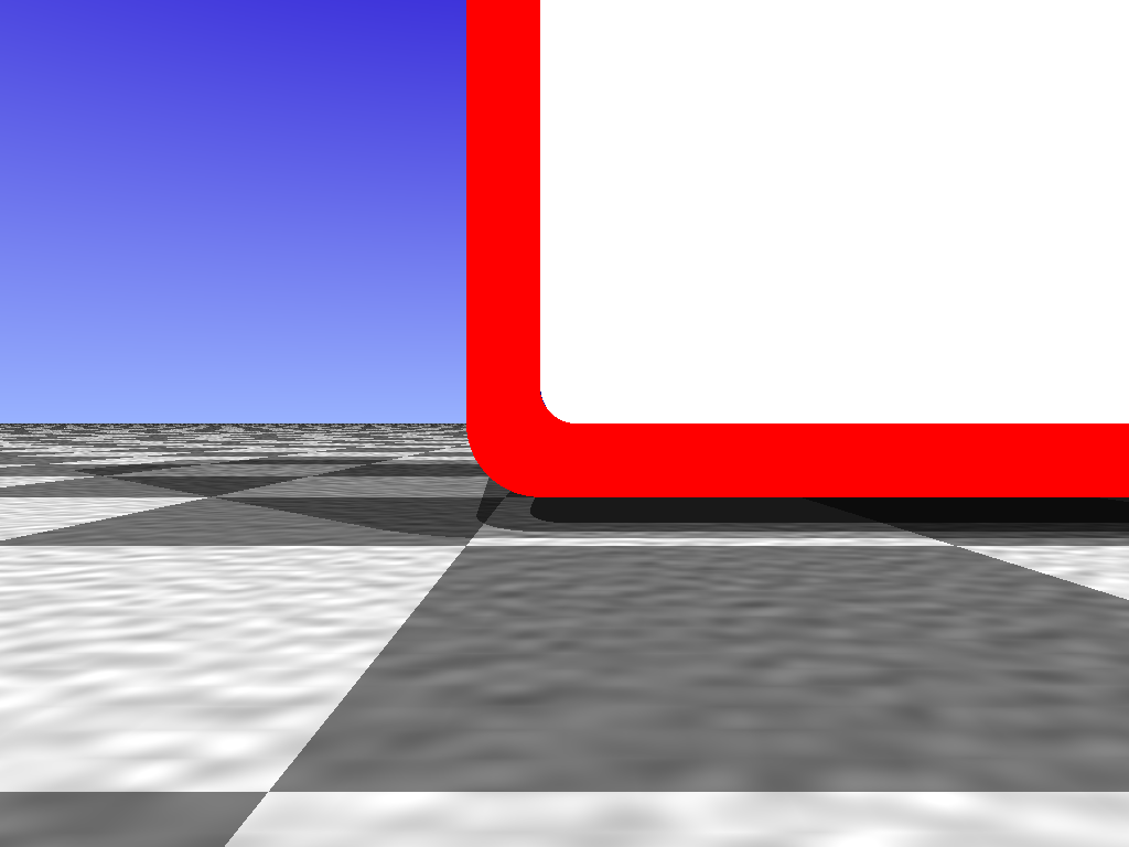

I have a weird simple csg error that I'm missing the solution to.
I'm trying to make a TV with rounded corners for the picture tube.
Seems simple enough.
union {
    difference {
       tvBox
       tvTubeCutout
    rectangle_with_image_to_stick_in_TV
but my rounded corners, inside corners for the screen are not working.
Can someone take a look?
// +a0.3 +w640 +h480 +itvTest.pov +otvTest.png
dik
Download 'tvtest.pov.txt' (5 KB) Download 'brokentvcorner.png' (3 KB)
Preview of image 'brokentvcorner.png'

I can't test properly but changing the above merge to a union mostly
fixes it.
Regards
     Stephen

Because you are using 'merge'? Replace by 'union' and all will be well.
If not applied on transparent objects, merge should be avoided as it
also is slower than union.

Is tvTubeCutout longer than tvbox in the direction of the screen shot.
If not, then coincident surfaces might be the trouble.
That can give your weird csg error, depending on object placement and/or camera
placement POV will calc the pixel colors differently.

Thanks. That was it.  I had switched it from union to merge; I was
getting weird coincidence errors on the main outer box. They've gone
away too.
(I think I was doing union {box {color Red} box {color Red}} instead of
union {box {} box {} color Red}
Weird that merge has that issue. I would think it shouldn't matter for
this application, just be slower.
dik

I too have been wondering about that. The only difference merge does is
taking out the internal surfaces of the objects, but works as a union
otherwise... or so I believe.

Not so weird if you understand how merge works internally.
In a union, coincident surfaces "only" compete for texture and interior.
In a merge, coincident surfaces _additionally_ make a mess of the
geometry itself.
The reason is that a merge works by ignoring surfaces of any member that
are found to be inside any of the sibling objects. If a surface is
coincident with that of any sibling, it's more or less pure chance
whether that surface will be judged outside that sibling object (=
visible) or inside it (= invisible).
(The same is true for intersection and difference as well.)
