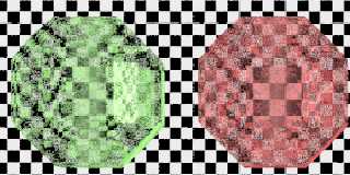

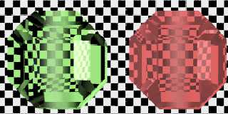

I'm playing with gems.  (I "wish" they were the real thing.  Just POV
stuff, though.)
I'm observing some anomolous (to me) behavior.  I'm using a declaration
to define the gem structure.  If I use an "intersection" of box objects,
I get a dirty or noisy material as a result.  If I use an intersection
of planes, I get a very clean crystaline result.  The code and resultant
images are below.
Using planes...
#declare xAngle = 45.0;
#declare yAngle = 45.0;
#declare zAngle = 45.0;
#declare xPlane = 1.0;
#declare yPlane = 1.0;
#declare zPlane = 1.0;
#declare CrystalJewel = intersection
   plane { x, xPlane }
   plane {-x, xPlane }
   plane { y, yPlane }
   plane {-y, yPlane }
   plane { z, zPlane }
   plane {-z, zPlane }
   plane { x, xPlane rotate  xAngle*y }
   plane {-x, xPlane rotate  xAngle*y }
   plane { x, xPlane rotate -xAngle*y }
   plane {-x, xPlane rotate -xAngle*y }
   plane { y, yPlane rotate  yAngle*z}
   plane {-y, yPlane rotate  yAngle*z}
   plane { y, yPlane rotate -yAngle*z}
   plane {-y, yPlane rotate -yAngle*z}
   plane { z, zPlane rotate  zAngle*x}
   plane {-z, zPlane rotate  zAngle*x}
   plane { z, zPlane rotate -zAngle*x}
   plane {-z, zPlane rotate -zAngle*x}
   bounded_by {sphere {0, 1.7321}}
   no_shadow
Using boxes...
#declare BrilliantJewell = intersection
   box { <-1.0, -1.0, -1.0>, <1.0, 1.0, 1.0> }
   box { <-1.0, -1.0, -1.0>, <1.0, 1.0, 1.0> rotate -45*x }
   box { <-1.0, -1.0, -1.0>, <1.0, 1.0, 1.0> rotate  45*x }
   box { <-1.0, -1.0, -1.0>, <1.0, 1.0, 1.0> rotate -45*y }
   box { <-1.0, -1.0, -1.0>, <1.0, 1.0, 1.0> rotate  45*y }
   box { <-1.0, -1.0, -1.0>, <1.0, 1.0, 1.0> rotate -45*z }
   box { <-1.0, -1.0, -1.0>, <1.0, 1.0, 1.0> rotate  45*z }
   #if (clock_on)
      rotate frame_number * (360/final_frame)
   #end
   no_shadow
The texture and interior definitions are identical, I just swap out one
or the other () declarations from above using the below macro...

The result using boxes...
[Image]
The result using planes...
[Image]

From: Patrick Hagerty
Subject: Re: A perplexity...
Date: 30 Oct 2005 13:12:36
Message: <43650E32.4CAFE6DC@daeoria.org>
<!doctype html public "-//w3c//dtd html 4.0 transitional//en">
<html>
Oops!  My images didn't see to upload.
<p>Trying again.  Using boxes...
<br><img SRC="cid:par### [at] daeoriaorg" height=141 width=291>
<p>Using planes...

From: Mike Williams
Date: 30 Oct 2005 14:52:01
Message: <SVQ3aJAYRSZDFw9T@econym.demon.co.uk>
>stuff, though.)
>images are below.
What's happening is that a box rotated by +45 is exactly the same as a
box rotated by -45, so you're getting the coincident surface problem.
See "2.4.2.5  Why are there strange dark pixels or noise on my CSG
object?" in the documentation.
If you delete three of the rotated boxes in your intersection it will be
the same shape but without most of the speckles. The remaining speckles
are caused by the fact that each of the rotated boxes have two faces
that are coincident with the unrotated box. E.g. the box that's rotated
by y*45 has the top and bottom face still in the same plane.
You can fix that by making the first box have a slightly different size.
   box { <-1.0001, -1.0001, -1.0001>, <1.0001, 1.0001, 1.0001> }
Date: 30 Oct 2005 17:45:58
Message: <43654E48.962996E9@daeoria.org>
Of course!  I did the "plane" method first and forgot that I'm dealing with
more surfaces with boxes than I am with planes.
Thanks!
Date: 30 Oct 2005 17:54:41
Message: <43655054.BFA2ECB2@daeoria.org>
OK.  I tried it.  It worked.
I was simply failing to think in three dimensions.  A plane is two dimensional,
a box is three dimensional.  That's what I get for doing most of my POV-Ray
work in the evening after a day of mind numbing work.
Thanks again.
> > >stuff, though.)
> > >images are below.
> > By the way: Don't post images to this newsgroup. Binary files should
> > only be posted to a .binaries newsgroup.
> > Mike Williams
